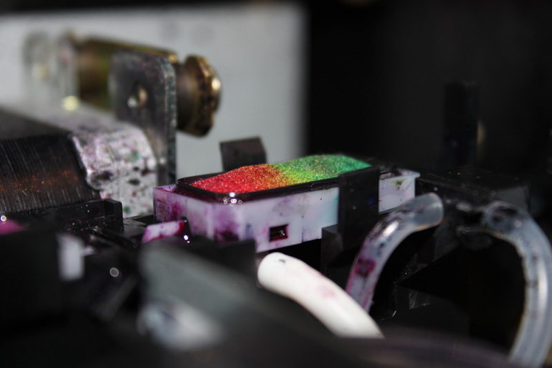

Got puff
here is a puff

I just came across this thread. We were the dealer that SlightlyChilled ordered the maintenance station from. I would also like to say that we didn't drop the ball. I had personally been dealing with this issue with Mutoh for about three weeks last June into July. Mutoh could never recreate the problem in house and because of this decided not to replace the station.

This appears to be one of our capping stations, and we have been modifying them to respond to the swelling cap reports.
Swelling caps are normal after a time period and the caps/capping station is considered a consumable item.
There have been reports of swelling in days or weeks which is not normal.
We have been unable to reproduce this inhouse using the same inks sets and the Mutoh cleaning solution that is recommended.
We have had some outside tests run with the same results.
The outside tests did test a variety of other cleaning solutions and show that water can cause swelling of this material.
So we cannot find a systemic issue that would warrant coverage under warranty, though we are still trying to help those affected where we can, as are our dealers.
I did send Chilled some pieces for testing to try and help out.
