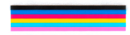

I have a problem with spraying on 9000s (white area around black color is stained).
The machine is new(six month old max) the spraying is mostly on the K
Regular maintenance is made every day normally.

Ahmed Samy Nagada
I do, I'm using 791 since I have started using the printer (it is new)
I have attached a scan to have a more clear idea.

Bill Modzel
Call your supplier or HP directly. The 791 series was defective in many ways. I had three colors in my 9000 that were running fine and than I replaced my magenta with a 791 and all things went to crap. Overspray just like your K is doing. They should replace your ink with 790 and you will need to do a complete flush.

Definitely deflection form the ink. Same thing happened to me with oem seiko carts. Switched to nazdar, problem fixed itself inside of one cartridge.
