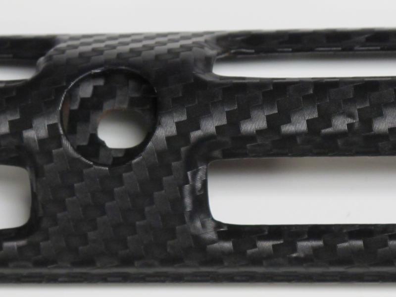

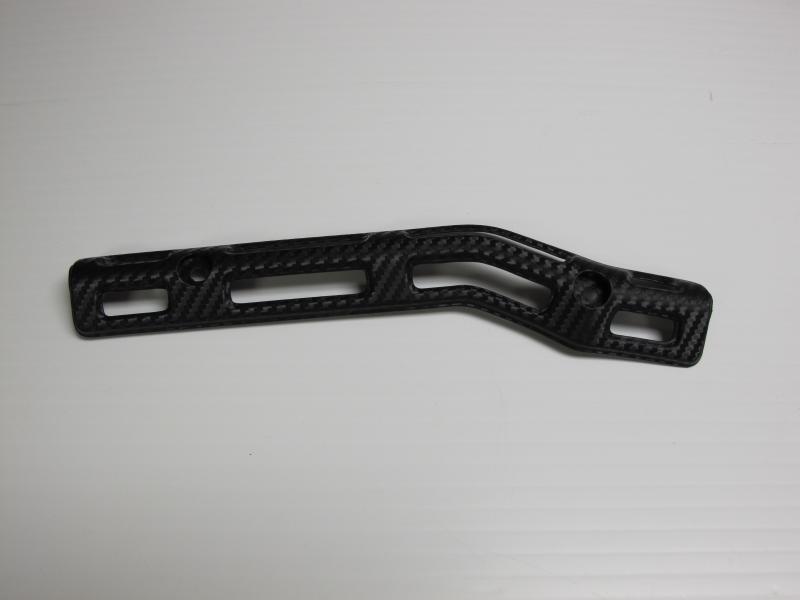

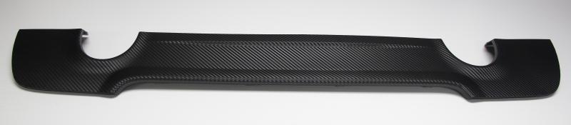

It's nice stuff. With primer and some heat it'll do all kinds of turns. I've got a big ole chunk of it to do interior bits on some family cars soon.
CheapVehicleWrap
Good stuff!
