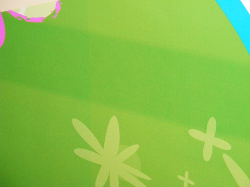

Sometimes the block is darker or lighter of that color. For example, In the one attached photo below it is a print of a palm tree with dark green on top. Every time I print this one particular file I will get the same results..the dark green then it goes into a lighter green then an even lighter green in a pattern just like that. It is like this each time I print it. It is not all images or files though. I can take numerous files and print them all at once and only one of those images will have fading in it. Everything else around it is fine. In the other example photo this is a print with a light green. Each time I print this file I get a 6 inch band of a dark green. Only in one spot on the print does this happen and each time. Then there are other prints I can do that have the opposite, a white fade on it in the same manner, not a dark color.

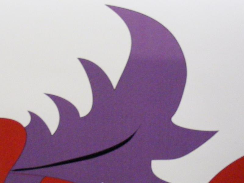

The third photo is of a red hat and on the top of the purple feather is an example of the color (dark purple) going into a fade (lighter purple).

It looks like it could be a media advance issue. As the machine pulls material off a heavy (or damaged) roll it can cause some weird patterns in the print.

It will do this fading in the same spot in certain files and nothing I do corrects it.
You might want to try a preripped file:
http://www.mutoh.com/kb/entry/68/
This will by pass your RIP and ftp files directly to the printer.
If it shows up with these files, then there is reason to look more closely at the printer.
This really does not seem to be printer related at all.
I dont know of anything in the printer that would know where that same spot in the image is.
The memory is much, much smaller than almost any image and only temporarily buffers relatively small pieces of a print.
Heaters, rollers, feed don't explain the same spot in certain files.
I would be looking at the RIP/PC that these files are processed.
Check this out^^^
I get similar weird banding and blurring when I put new types of media on my Colorspan. Generally just cranking up the pinch roller pressure a little more, or decreasing the tension on the media roll will fix the problem.

I tried new profiles today from oracal's website which are meant for my media and SUCCESS no more banding. Even though I tried different profiles before I guess I got lucky this time. Atleast for now it is working..I printed the palm tree and no banding at the top. Only after 4 years..geez.
