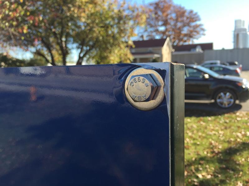

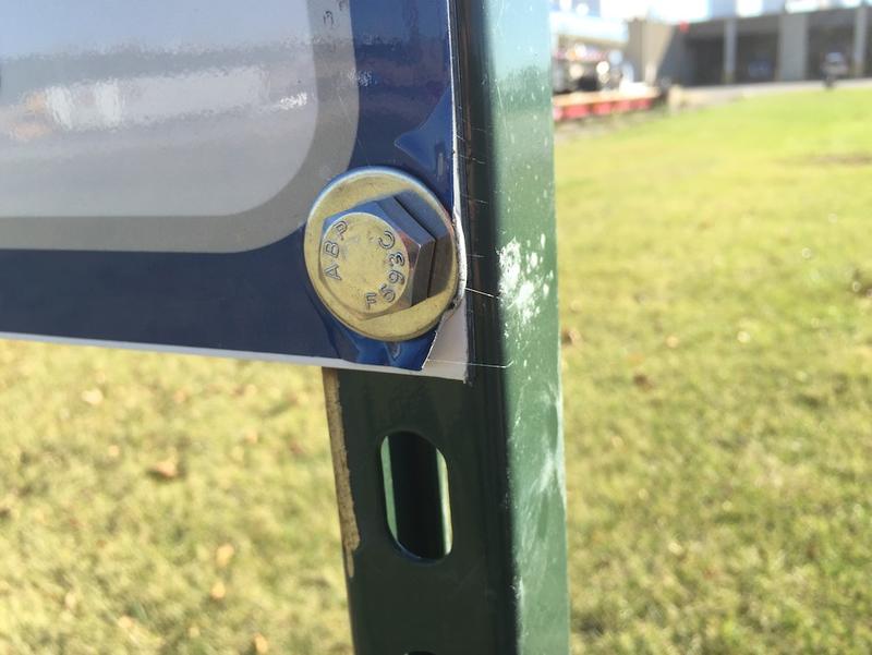

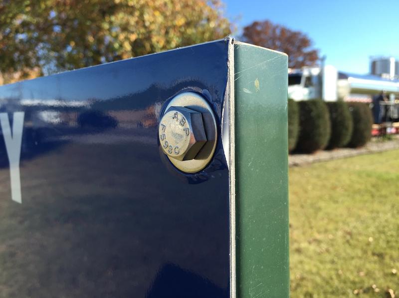

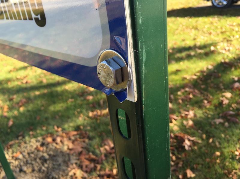

So I stop by today and check it out, and sure enough, it's doing this on the right side of all of the signs. They were printed by Signs365 and it's Oracal reflective. My question is, has anyone seen this before? I guess the easy out would be to blame it on how they installed it, but I've never seen any vinyl do this before, even if they did tighten the snot out of it. I suppose a bad batch could be possible, but why only on the right side? Because you would think it'd pull on both sides if it was from tightening. Is that just a happenstance that it's like that?

They over tightened the bolts, probably put them on with an impact gun., can you trim around the washer with a knife and reset the vinyl? Other than that there is no real way to fix it.
it's 100% the clients fault, they over tightened them, but judging by your stories, they will never see it that way.
Most definetley over tightened. The painted aluminum surface might be causing it to not adhere as well. But they definetly over tightened. You also should always use a fabric washer between the metal washer and the vinyl. This will help the metal washer to spin on top instead of digging in and twisting the vinyl.

I guess I might as well cut it and try to re-set it on there...I have no other choice at this point. I don't get why it only curled on one side of the signs, but that was my first assumption too was the giant bolts/washers they used, and then tighten the snot out of it. It was ACP/ACM substrate.

On some of them it is all around. And in a couple days it will be all around the bolts and wave out from there a little bit. There is not much surface area between the bolt hole and edge of the sign. So this is the easiest place for the vinyl to start pulling up. There is most likely tension on the inside portion also but since it can pull it all the way off it stays put until the tension starts to stretch the material. You need to unbolt and loosen that tension. Then tighten correctly and add the vinyl around.

Or they used the impact gun on the one side, saw what happened and were more careful on the other side. but still want to blame you
