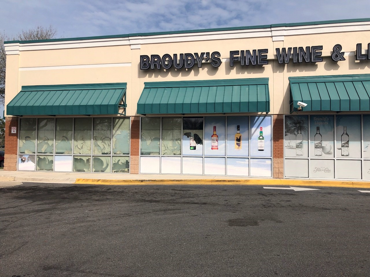

Just finished 33 window mural removal at beach that was 12 years old. Went through a stack of 4" scraper blades. Better believe we used rapid remover. The time it saves over other methods more than justifies the time to properly clean after for new graphic application on this size job. After glue residue is removed we clean with rags and rapid tac, then alcohol with more clean rags until tape test works on window panes. The guys are out today with hot pressure wash rig cleaning sidewalks in prep for TPC.
