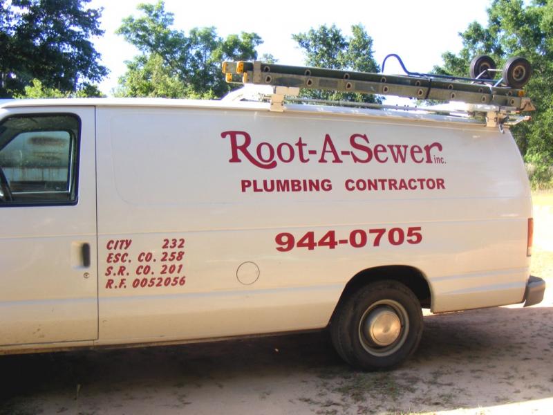

printed media, no matter what prints it or whos inks you are using.....wont last more the 3 years....and most of the printer manufactures will say this.
now for longevity.......HP VINYL (avery red with silver backing) can and i have vehicles(in n.florida) 13 years old and still look like the day it was installed(2001)....this picture was take 2013!!!!!
