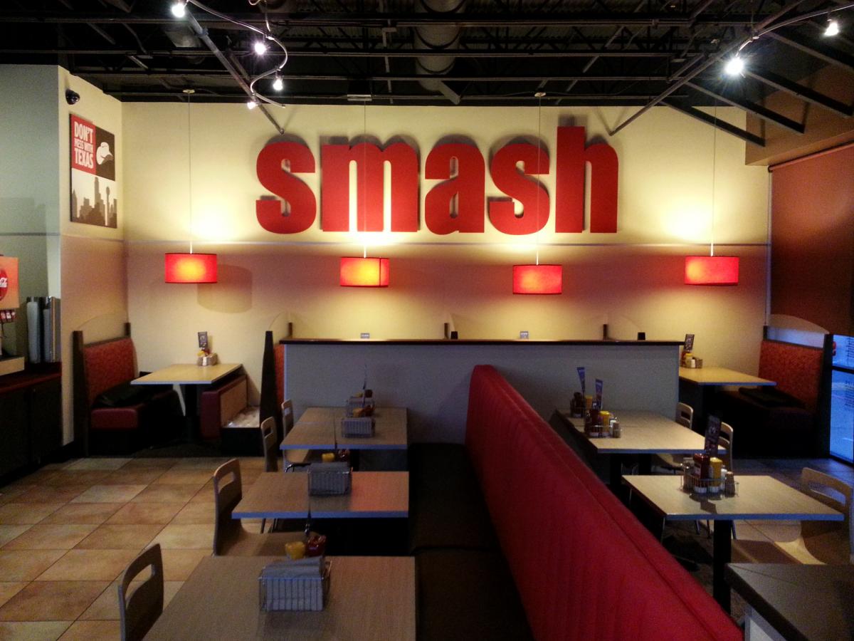

You'll be fine. Use a liberal amount of silicone. If it were me, I would use pads along with studs.
These were around 1" thick and 3'-4' tall and were installed with studs/pads/silicone.
