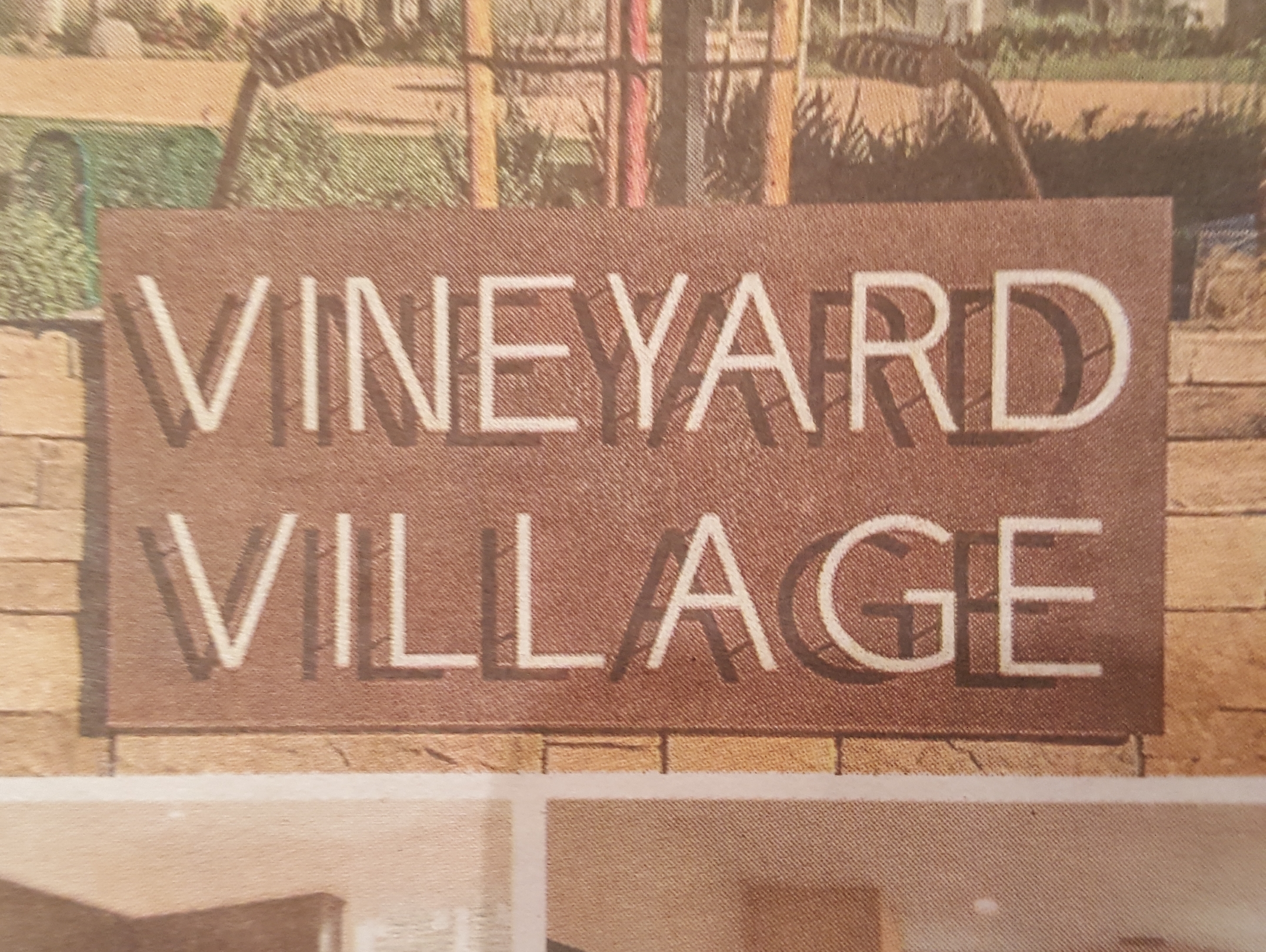

I found this advertisement in our weekly newspaper for a housing development and they included the monument sign in the ad. This really illustrates the point I was trying to make about excessive standoff on your letters. Especially thin stroked letters. These are spaced so far off the wall, you can practically see the entire stud.
The logo is actually half decent and woukd gave made a nice presentation, but the sign vendor butchered it horribly.
