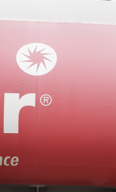

We're on the equator so we could have super UV exposure:
The red is not printed, it is 3M180c-13 Tomato Red Controltac. Been on there about 9 years now. Still tomato red on the underhanging part of the tank but tomato white all along the top. We are in the process of replacing it with 3M 2080 Dark Red. 2080 is supposed to have a built in uv overlam layer to protect the color . In another 8 to 10 years I will report back with results.
