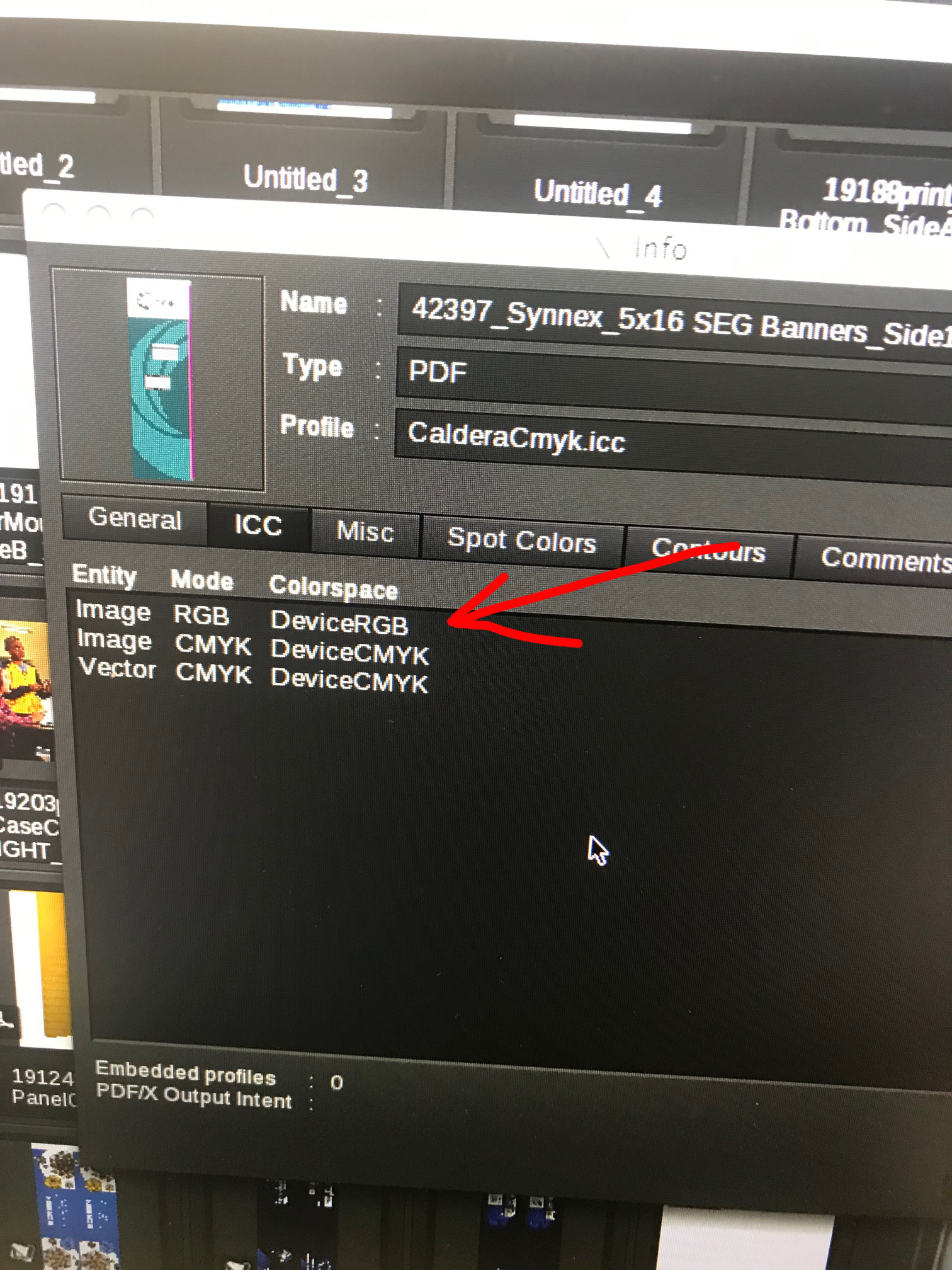

We see it in output. The second you embed the image, it takes on not only Illustrators working ice profile, but also the documents raster effect resolution. If that exceeds the 2 gig (or whatever it is exactly) Illustrator raster ceiling...it downsamples it to clear it.
Andy_warp
Until they get touched by an operator and / or RIP settings.
Right! It lets you send a layout to your rip with various color spaces and icc profiles. Even different color spaces. If you embed an rgb image in a cmyk Illustrator doc, it is now cmyk with Illustrator’s working space profile.
We avoid the image being processed twice, once by Illustrator and once by the rip.
Andy_warp
I profiled our whole color set up...create all templates...manage the graphics department...and run the printer...EVERY file he processes I see. I do all of the tech work on the machine, and all customer interaction.
I would say I have a little practical knowledge. Smart guy.
To demonstrate this as a FACT, I have included 2 screenshots. For one of them, I placed an rgb screenshot and embedded into a cmyk layout. The other one I placed as a link and saved as a pdf.
