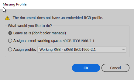

So working with onyx of course and tried to do some work with an eps file.
Well no profile is embedded so the colors change. Have i been missing this all along and well eps files do no embed icc color profiles??
I can save a eps then reopen it and it always tell me that no profile is associated. Do i want to apply a profile or no?
Attached an image.

I was having color issues so i didnt start getting this message until i talked to a color rep and he had me turn on the notifications for files when opening or pasting to tell me the profile or if it didn't have one so i could try and nail my issue down.
EPS files are a legacy file format and as such, do not support the use of working space profiles.
PDF files support the use of working spaces, but not all PDF files make use of this.
PDF files are able to embed working space profiles.
Yeah the only way i can seem to get clear text and some other things is to save PS file as PDF and open in AI. Then save from Ai as PDF after making mu contour cut lines.
Just really throws me off bc most places will send you a EPS file but if there is no embedded profile how do you know that the color is correct if it was based off spot colors and so on?
I guess it keeps the spot colors but nothing else.
Guess it would suck if you assigned it a cmyk profile when it was designed in RGB or vise versa lol..

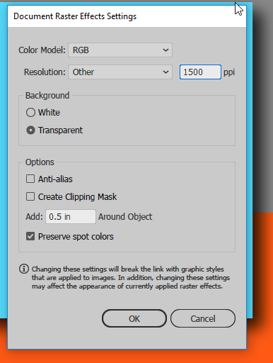

You can change the raster effect setting to anything you like once you create the file at 300 dpi.
Its under Effect then Document Raster Effect Settings.
Nice!
That could really let you build an Illustrator bomb!
A 200" file with that set too high my bring my rip to a screeching halt!
Thanks AlteredDezignz!

We have done a bunch of 10th scale 1500 dpi to have a final dpi of 150 and it is ok a little slow but not to bad.
Andy_warp
I think we have come across problems with this by hitting a resolution/file size ceiling in the pdf.
I wanna say it's 2 gig...which depending on the overall length you can hit fast.
