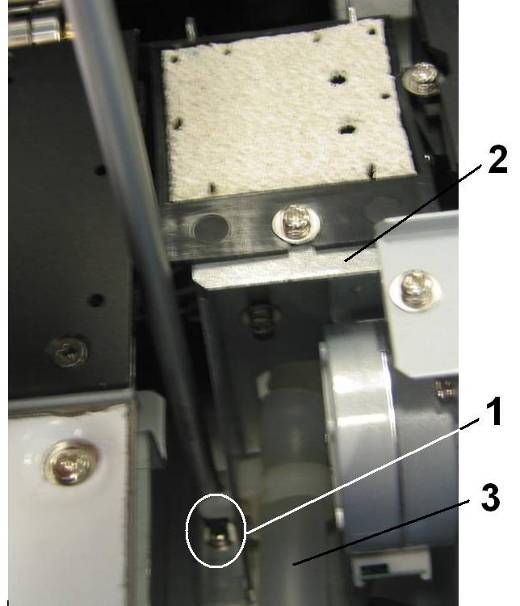

What wick do you think, you think this on photos? I changed the sponge but nothing better has been.

GAC05
Quit buggin' me
Can you show a sample picture of the problem?
Are you getting unwanted drops of color on the material as the printer carriage moves left to right?
If this is the problem then what the others have said is most likely the problem.
The picture you posted does not show the area you need to clean.
You have to move the print head into a position that will allow you to see the underside of the print head.
I don't know how to do this on the Spitfire, one the 1304 I have to remove the cover on the left side and slide the carriage all the way to the left.

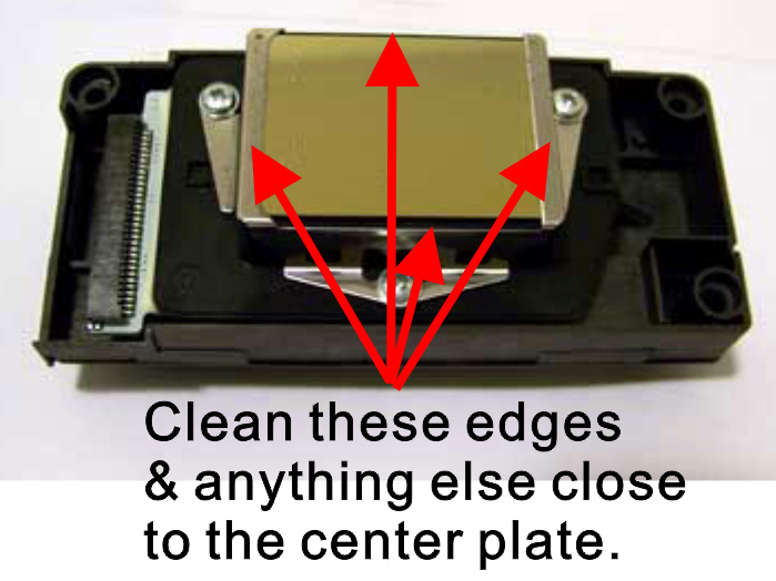

You are looking for something stuck to the head in the area of the print plate.
It could be a fiber or lint off banner media. A thread or hair will get stuck in the built up ink and absorb ink spray until a drop gets big enough to drop onto the print as the head changes directions.
Clean everything on the bottom but do not wipe the central nozzle plate directly - just the edges around it.
If all is clean then there is something else going on.
