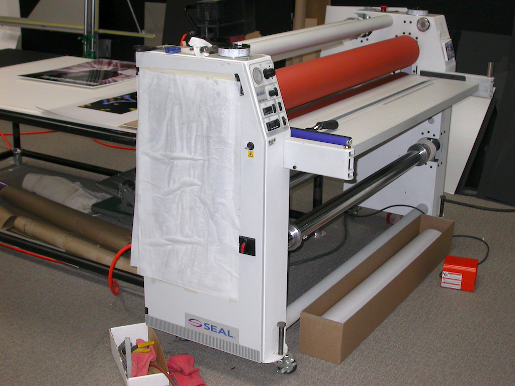

Does anyone use these?
Boudica
This is not a braver, this a silicone roller, 6” that picks up lint, dust and small debris. You roll it over a adhesive sheet to get dirt off so to use it again.
Dust Removal System.
So, this is for rolling over the adhesive side of vinyl? Does it work? Trying to picture how and when that works...
ColorCrest
All around shop helper.
The photo shows the blue roller tool on the feed deck and its makeshift stack of cleaning adhesive taped to the side of the machine. The roller is minimally sticky and will grab debris from materials. So to clean the debris from the roller, pass it over very sticky adhesive to remove the debris from the roller. Change-out the adhesive sheet for new when needed.
