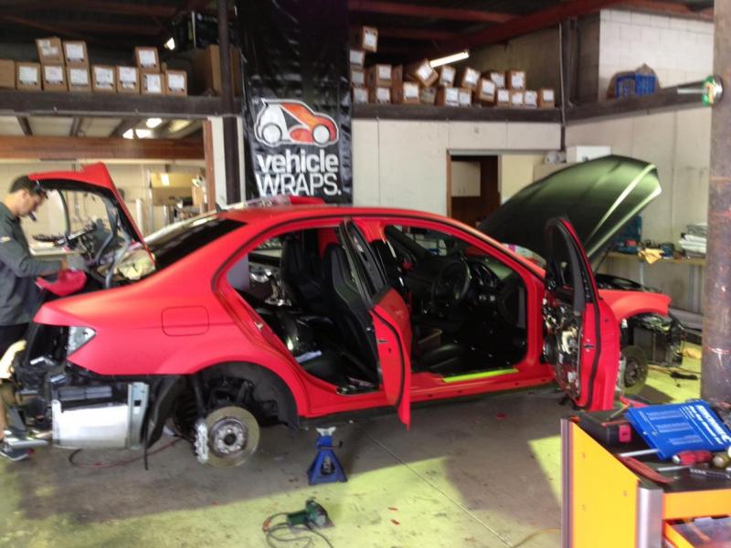

Here is a wrap i found being done which had the jams done...
marcinito , did you wrap the jams first or after the exterior?
