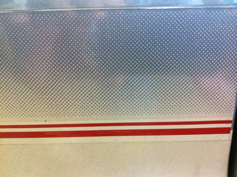

Just had a body shop call me, because they need this stripe. He said he can order it for $350 or so, but I'm thinking if I can figure out a way to do it, I can do it for less than that. Not sure. Anyone know anyone that either does this, or have you ever tried to do it on a modern day printer? I'm assuming the worst part will be recreating it and matching these colors. I don't know if I can ever get this "look" again.

I have an AI for you... it's over 1mb so i cant attach it here, and i know they frown upon external links for images, not sure about an ai.
Shoot me a PM and i'll email it to you.
