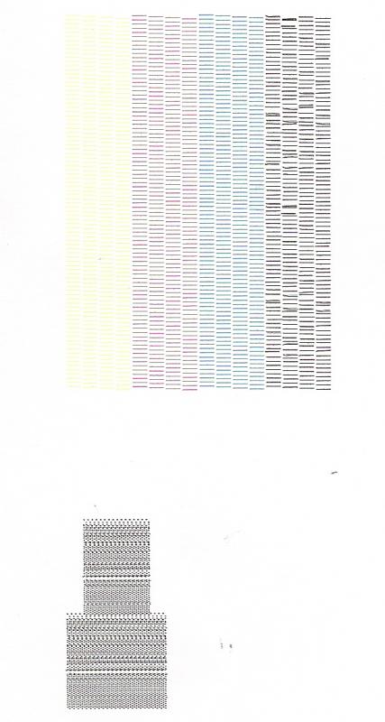

Basically we started seeing banding in our prints. We noticed the test print looks different than what it used to be, especially at the black section (some dots looks as if they not at the right place).
We tried to do normal cleanning, medium cleaning and powerful cleanning (once), all did't make any difference.
See attached picture. Is there anything I can do to get this to look better?

You got deflection in your nozzles. Maybe try soaking the cyan/black head to see if it can be recovered. Worst case you'll need a new head. When we had our SP we had to do this.

Thanks Jason. Antwhere I can get a procedure or good instructions for soaking the heads?
I only see a problem at the black (K) section.

I'm sure someone on here will post it. It tends to happen on the black portion of the cyan/black head. Usually head strikes and the black ink take its toll. The head is split into two so cyan and black come out of the same head but are on different sides.
