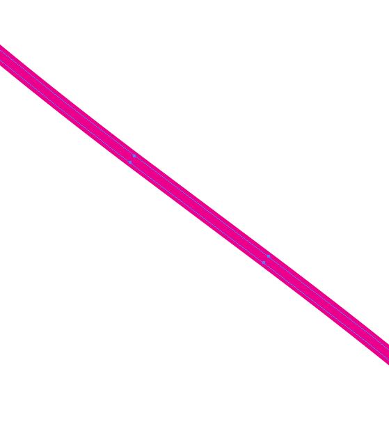

I've checked and double checked the file, I can't seem to figure out what's wrong. It prints, then cuts. But when it cuts, it cuts one direction, then back over the same line in the other direction. I checked in Versaworks, and it's set to cut once. The stroke is .25, and there seems to only be one of them. Any ideas what I might be doing wrong?
I attached the PDF if maybe one of you is feeling extra helpful and can peek at it?

Just opened it up in Illustrator and zoomed way in on your cut lines. There are two of them if you zoom way in. Midway does not have it, but everything else does.
StudioSignsInc
Your line is actually two lines - see attached pic. That was taken from the "S"
Bly
If you're flattening pdfs in Illy make sure you turn off "convert all strokes to outlines".
MikePro
+1 stroke becoming two lines... which is why I set my cut shapes to fill, not stroke, just to be safe.
