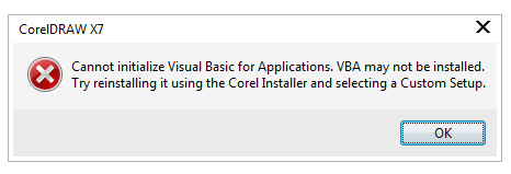

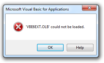

    all of my macros stopped working a few days ago and I get error messages when I try to open any. I did not change any settings on my computer and i have windows updates turned off. I tried to repair the corelDRAW install hopefully thinking that would fix the issue and that didn't work either. This is running on win 7 btw.

    I did a search for that file on my hard drive. Came up with 2 associated with Microsoft Office.
    "C:\Program Files\Microsoft Office 15\Data\Delta\root\vfs\programfilescommonx86\microsoft shared\vba\vba6\vbe6ext.olb" (folder)

    I checked and I do have that file on my computer, Its not from MS Office i have never had that installed on this computer. I'm thinking i probably need to wipe the OS and stat fresh again, it could probably use anyways.

    well i finally figured my problem out. I had to download a trial of office 365 and that somehow installed the correct VBA file and everything is working again.
