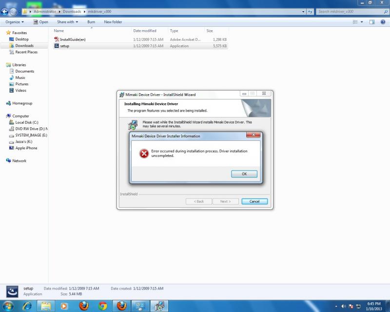

    So im trying to download the mimaki driver for my jb3-160s i am using windows 7 64bit and it says when im downloading it a error occured during installation but when i look it has actually downloaded so thats weird, another problem is when i connect the printer to the computer with firewire, it has a (!) on it any ideas people would be great.

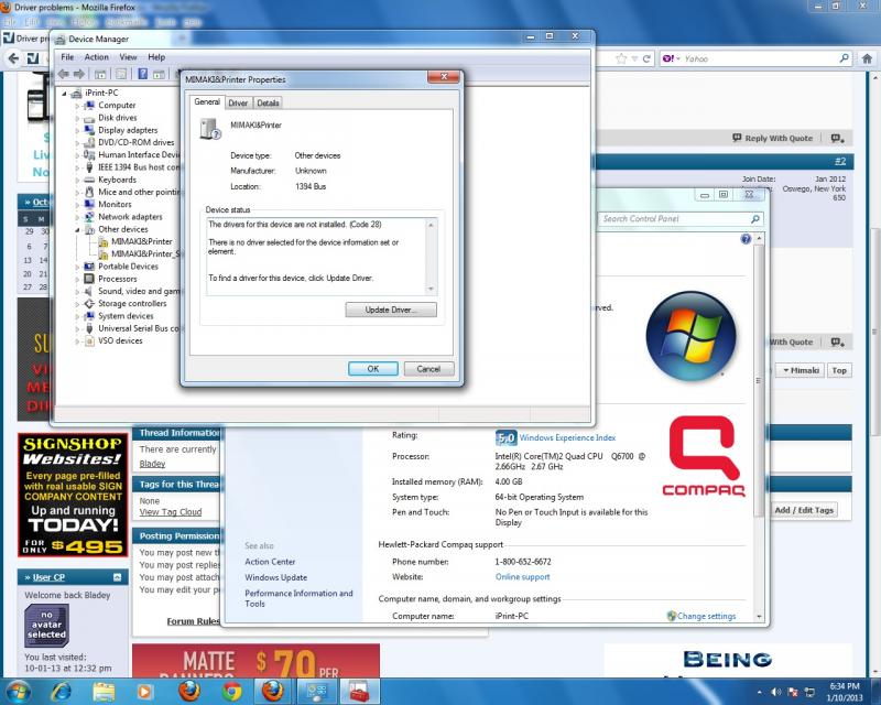

    the ! usually means theres an issue. Can you click on the ! to see if it tells you ?

    here
    fgfg.jpg and this when i try install the driver sdsd.jpg any ideas peeps.

    Maybe try the current driver? Another thing to try, right click the executable for the driver and choose run as administrator. The driver you are trying to install is an older driver from 2009 (it "should" work) but there is a far newer version of the drivers, version 3.40 from June of this year. Also, disconnect the printer from the computer. Leave it disconnected, install the driver, reboot, then connect the printer.

    Yeah i have tryed all that what you said and tried the newer version but still same result it has got it stumped this 1
