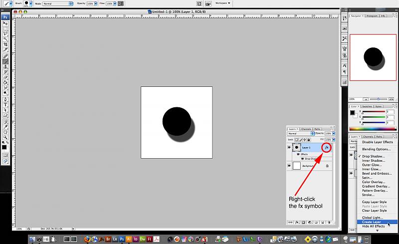

if you are making the drop shadow via blending options and doing it from there you are going to run into problems like this. all you need to do is go to the layers palette and right click the "fx" icon on the layer representing the blending options, scroll to the bottom until you see create layer, and then click ok. This takes the drop shadow out of the blending option and makes it its own private layer. The downfall to this is you cannot bring it back as a blending option. The good thing about this though is that you can edit the drop shadow with an eraser tool or anything else now on its own -- and you can export it to flexi with no issues.
GK
pics help :wink:
