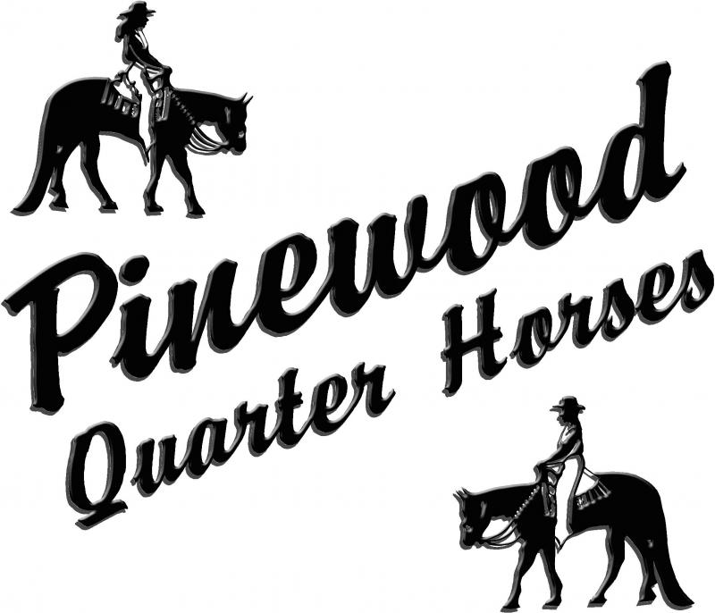

i have a text with a bevel i added in ps, brought it back into flexi for drop shadow and contour cut. the area where the text meets the drop shadow is pixelated with white showing?? any clues?
WOODBS
yahh..not sure if it will help though? hard to see the detail.

I get them white lines in my shadows sometimes when using Illustrator, but when I print it there not there. Maybe print a small test print.

Did you bring the file into Flexi as a transparent bitmap? If so, I would suggest making a vector mask around the text to clean up the edges and then add the shadow.

i tried to create an inline on the original text and separated it tehn aligned with the beveled text..masked and the beveled text disappeared?
