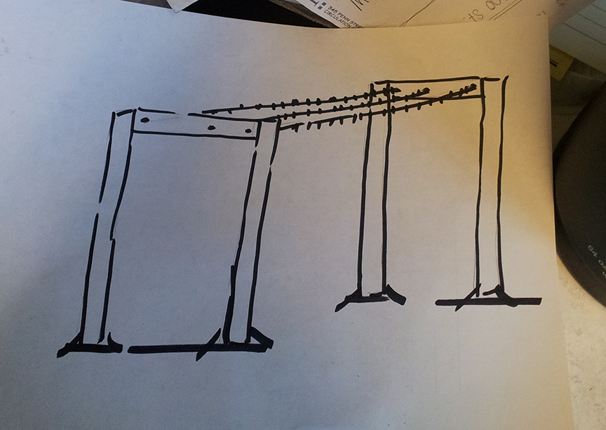

  6. Gino
    Gino Premium Subscriber
    33,476
    2,382
    113
    Jun 7, 2006
    PA
    I used to hand paint 100's of paper signs a day. The rack was simply some 2x4's made into a square, about 6 ft tall and 5 ft wide. Another square about 8 ft down from it and supported and anchored into the floor. Three washline ropes hung from one end to the other. Clothespins is what held the posters up, while they dried. About once an hour, I'd take them down and stack them. The best thing is air circulation, which will be the same for your prints. I had room to hang maybe 60 or 70 signs in there, using whatever lines I needed.

    Here's a quick idea. Remember, this was probably 45 years ago when built. dry rack.jpg
