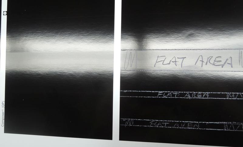

I started getting these dull streaks in my prints, same location all files? I did receive a "data 3 error" message while printing but reset the printer and the file printed but still with the streaks?
Any help would be appreciated.

Can you still see it after lamination?
If so, it might be the head going south soon, or just needing cleaned.

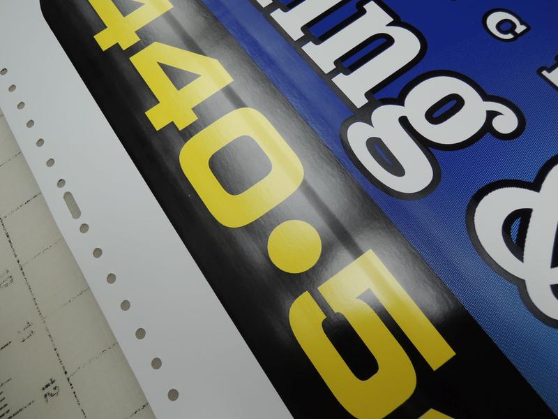

Thanks, I did clean the head and I usually do not laminate edge prints. It has 2 streaks about 5/16" wide (shown) and another about 1" wide (hard to see in the photo) above the two 5/16" streaks.
I'm sure it's a heat problem, I checked the cables and everything seems snug. I'm attaching another pix.

I would check:
1. Original media before printing- make sure there isn't a streak on the new vinyl.
2. replace / clean vinyl squeegees
3. clean platen- roller-
4. shine flashlight on the printing head- verify its really clean- no smudges / specs

Well I changed the data cable and still have the "dull" steaks so I'm fairly sure it's the print head.
Has anyone changed their own print head or is this a Gerber only job?

Look at the ground straps, especially the one between the top and bottom halves of the clam shell. It could cause streaking.:thumb:
Bcrawf
Thanks for the tip but the strap is perfect. It seems to be a heat problem with partial areas of the head not heating the same as the others. I can take a heat gun and bring the shine back to the dull strips but I have to be careful not to "blister" the vinyl when doing this.

Hello, perphaps FA supplier problem, you can check the Voltage that the FA "give" to the printhead...
