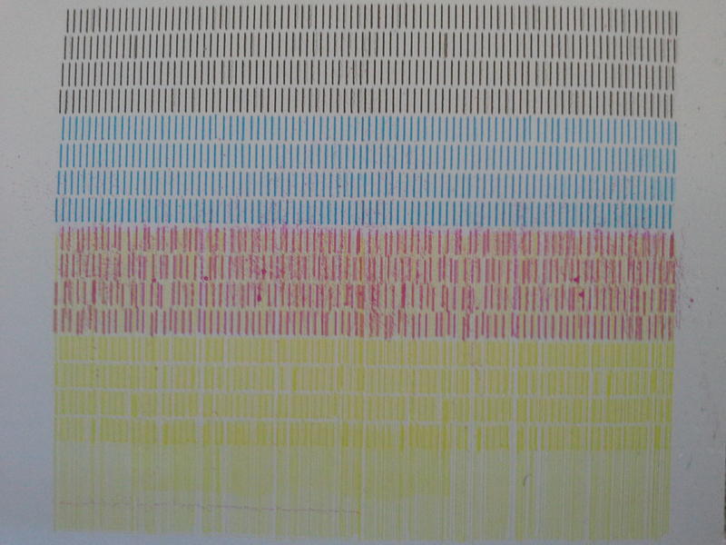

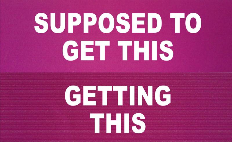

Hi, When I got back to work this year, I found that on my SP 540 V, The head that fires Yellow & Magenta, on the magenta only, it prints lines. I tried cleaning in, did a head wash, even changed the data cables on the head and checked for any leaks on the ink pipe, but to no avail. Is it possible that that head needs to be replaced?
Any advice would be appreciated. thanks
jcf54029
Test Print
Attached is my current test print and also how i need my prit to look & how it's looking now. and this is only the colors that use magenta that does this
please help. Do i need a new Head?

your yellow channel is firing on its own. You have some sort of electrical problem. You could swap the head cables and see if the problem shifts over to the black/cyan head (unplug the printer before trying this)

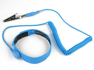

But be careful, unplug the printer, wear a grounding strap on your wrist and the other end attached to the machine ground (metal part), I have seen many tine when folks on here swap cables they blow fuses and static ZAP their electronics etc.
This time of year we generate a lot of static electricity!
