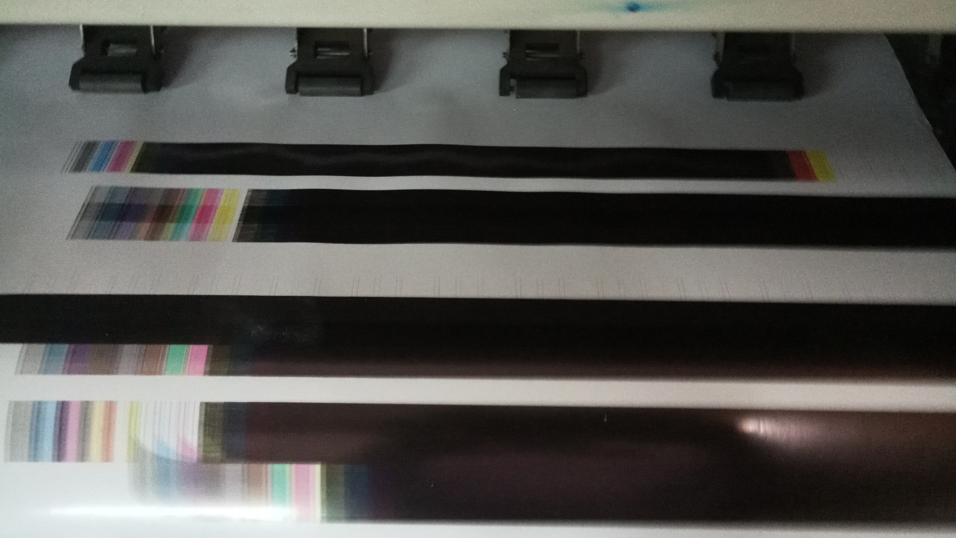

Hi,
My Dx5 printhead is printing black band.
I changed motherboard, headboard, head, cable head, long cable flat, optical fiber
it's always the same thing I do not know what to do.
zopylote
head flat cables
try to disconect and conect better change them right now, maybe already the head blown out if you can’t see colors any more
don’t turn on the printer before verfifying the head flat cables
before disconect flat cables disconect printer from outlet and discharge capacitors (turning on the printer with no conection)
fuzzy_cam
The Granbury Wrap & Sign Guy
I can't really tell from your photos, but it looks as if your material is buckled pretty bad.
