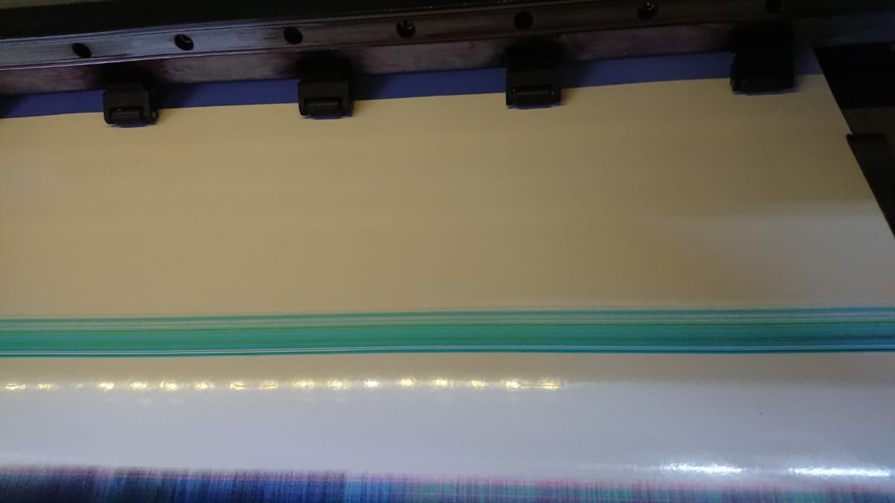

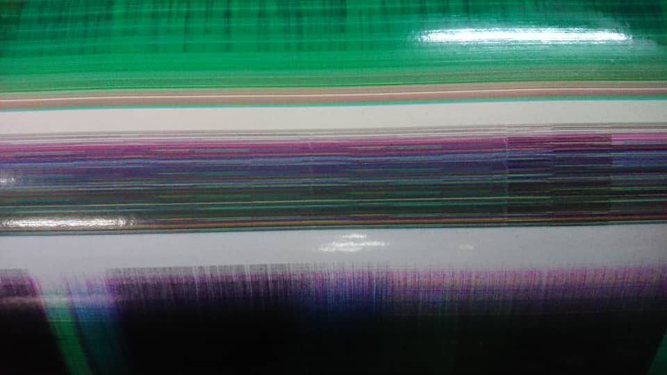

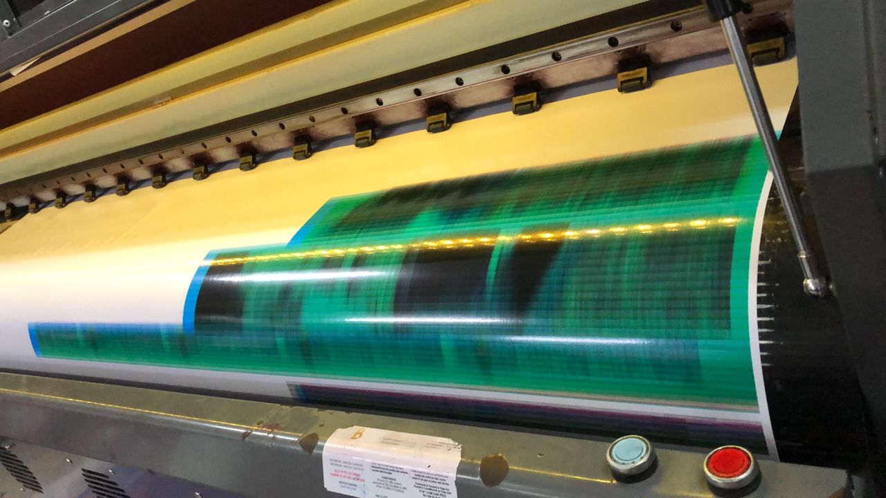

I have a Chinese eco solvent printer with dx5 printhead , i have install it 5 months ago it was working just fine , i turned off the machine and the next morning when i turn it on it start print all colors together , i changed the with no luck.
I attached photos for check nozzles and image print.
Any suggestions please

Attila Nagy
It happens when your pump blocked and left liquid in the capping station. The ink could move back and get mixed mixed in the dampers.
Dangreenst
I've had quite a bit of experience with Chinese printers they are unpredictable. Good idea changing the cable generally this is a electrical issue could be the printhead or the slider board.
When this happens it is due to a bad cable or a bad signal. If you have already changed the flex cable and you have the same problem, I think the next step is the head, if it were a slider problem, it would not print anything.
when you changed the flex cable did it have ink ???
ppnai
Thank you guys for your help
Yes when i changed the cable i found some inks on the connection but i cleaned it well before installing the new one
I will try to change the dampers to see if it will work if not i will change the head
Thanks again
Hello
okay when you have ink some of the connections inside the head are not allowing the cable to connect properly. That's why it prints a single color in full ... what I have done is clean the inside of the head with alcohol to remove the ink and let the cable have a good contact ...
You have to be very careful because if it gets wet with alcohol and you turn on the machine you can cause a short circuit.
you have to determine if it is worth the risk
A: You can solve the problem just by cleaning and changing another data cable
B. Or you may short-circuit and damage the printhead and some board
these are the possible consequences.
