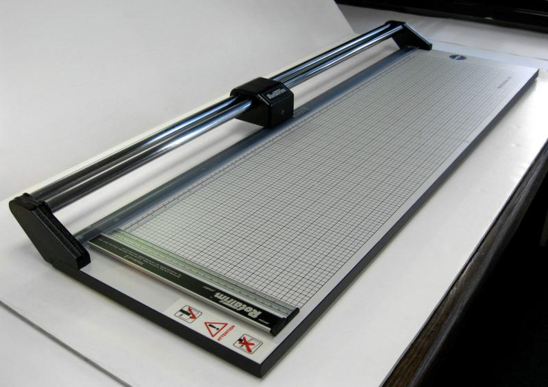

My problem isn't weeding, it's trimming the excess paper along the edges of a masked graphic with a sicsors, I guess you need a table plotter for that. $$ kaching
A good slide cutter works great for trimming down pieces, makes it easy to keep everything nice and square.
