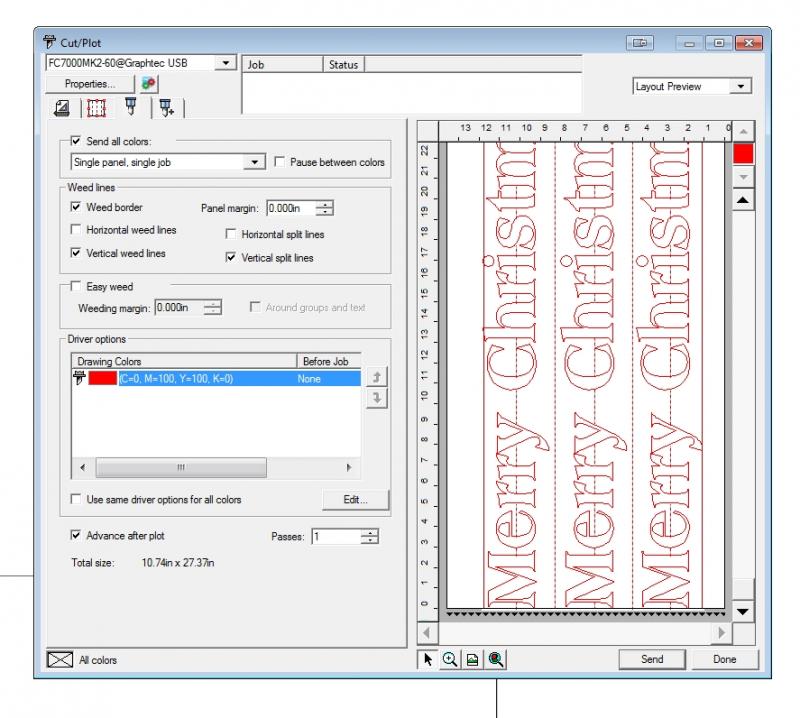

If your using professional sign making software you should have some options in your program like this in Flexi.
Here are some weed options to make things easier...
Weed border, vertical weed lines, vertical split lines, horizontal weed lines, horizontal spit lines, easy weed, etc.
Vertical weed lines and split lines make weeding much quicker... weed options.jpg
