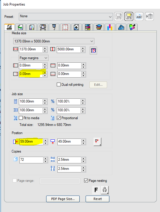

rjssigns
I'm geting used to Flexi again, but I remember seeing a margin adjustment somewhere. Mine is set 5mm from the edge.

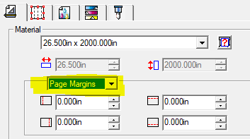

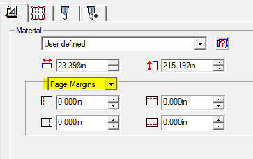

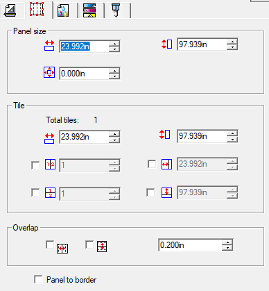

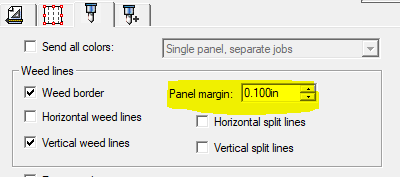

Hello!
My advice would be to check all of your margin and panel settings. I've included screenshots where I found my settings.
Almost all of my settings are zero and I've never really had a problem with a margin. My problem is accidentally scaling up the document. >.<
Let me know if that works for you!
