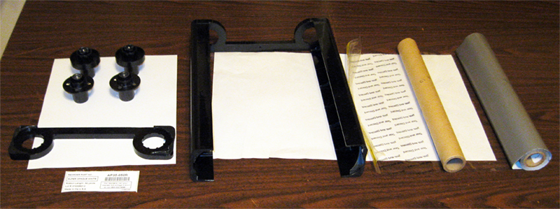

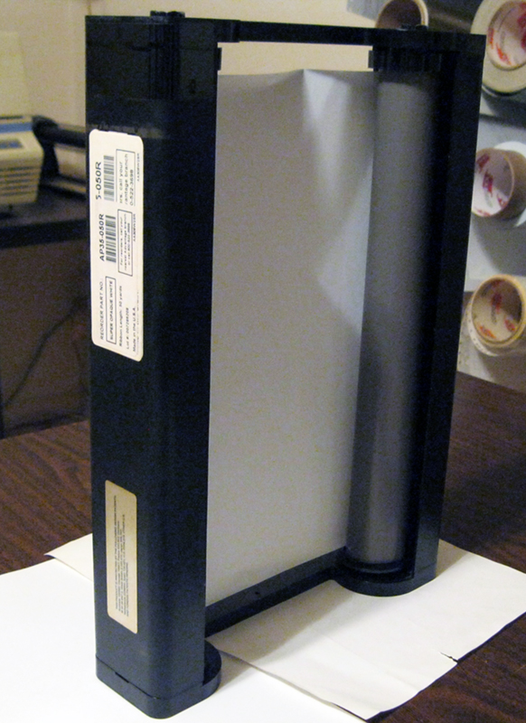

The first thing you need to understand is that the cartridge is a convenience item provided for ease of handling. You can actually run the feed and take up foil rolls without a cartridge. My point in telling you this is that it doesn't matter much what you do to the cartridges to get them open. That said, here is what I do:
- A band saw works best. If not available, then use a fine tooth saber saw or a hack saw to cut the bottom of the cartridge where it is welded to the sides on each side freeing the bottom. My definition of the bottom is the bottom when inserted into the Edge and the end caps are smooth. The top end caps have sprocket teeth. Once you have removed the bottom, clean off any sawdust from both the bottom and the remaining cartridge.
- Remove the four end caps from the empty rolls in the cartridge. The old rolls can be discarded.
- All four Gerber end caps have splines that fit into the slots in the Gerber rolls. Duracoat provides a slot in the top only (matches up to the sprocketed end caps). You will need to remove the spline from the bottom end caps by sanding or grinding it off well enough that the end cap will fit completely into the new Duracoat rolls. You're now ready to refill your cartridge.
- Lay the empty cartridge on its back on a table ... bottom off to the side and bottom opening at the bottom.
- Unwrap the DC refill by removing the short clear tear off at the perforations after pulling the glued down portion away from the roll. Insert the sprocketed end caps into the tops of the roll with the splines going into the slots of the roll. Insert the bottom end caps, insuring that they go all the way into the rolls. Unroll the two rolls slightly and lay them into the cartridge with the full roll to the right and the empty take up roll to the left. The glossy, non-printing side should be down. The top end caps should pass through the cartridge openings for them.
- Cut some vinyl into strips measuring 1" x 4.25". I prefer black but any color works fine.
- Place the bottom of the cartridge on the bottom of the open cartridge with the end caps protruding through the holes and so it matches up to the cartridge. Holding to together, stand the entire unit up with the bottom up. Holding it tightly together, apply the vinyl strips to seal each side to the bottom where it joins it.
- Apply the Duracoat label over the existing Gerber label in the same orientation.
Your refilled cartridge is now ready to use.
