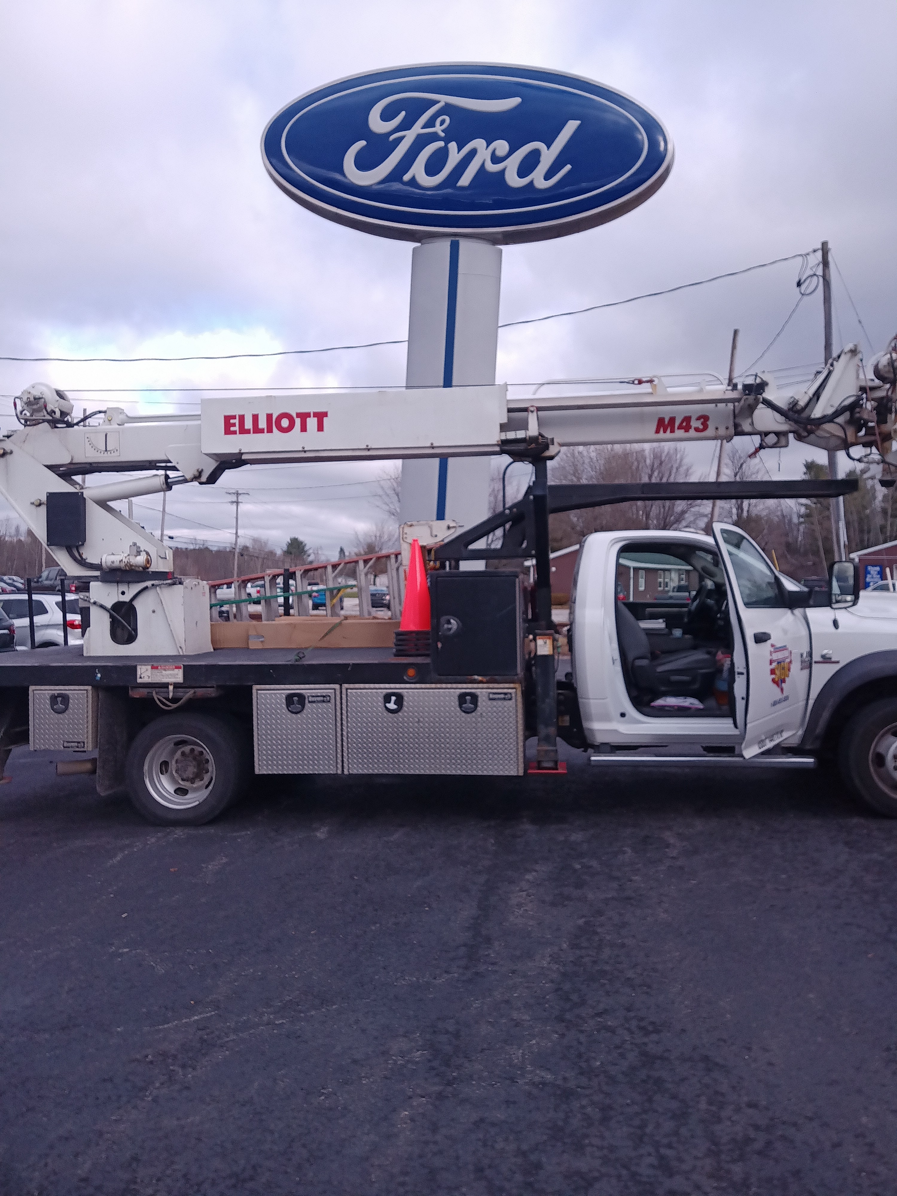

It can't be the filter if it works sometimes and all other functions work. Can't be the oil, same reason. Can't be a hose, it goes down fine and will work sometimes.
Going to test the coils and see what's up. That is where I'm thinking it has to be. Hydraulic systems are pretty simple, but the Elliott's use electric over hydraulic, so just more fun to test.
As for the temps, it was in the 40s here the other day, same issue. It was -16 this morning, so I'm not messing with it until next week.
I will pay what the coils ohm out. Maybe this will help someone else at some point.
jdragun
Coils ohmed out correctly. Swapped up down with platform rotation. Same issue.
She is going to an Elliott mechanic. Chased it to much already. Time for the pros. I can't trust her anyway, so a full once over is due.
Thanks for the input.

Went to the Elliott guys. Found some bad wiring in the boom. The wire insulation is cracking pretty bad. Ordered a new wire harness for the boom, $650. Looks like an easy install.
So it is definitely electrical, and the wiring looks like shit.
