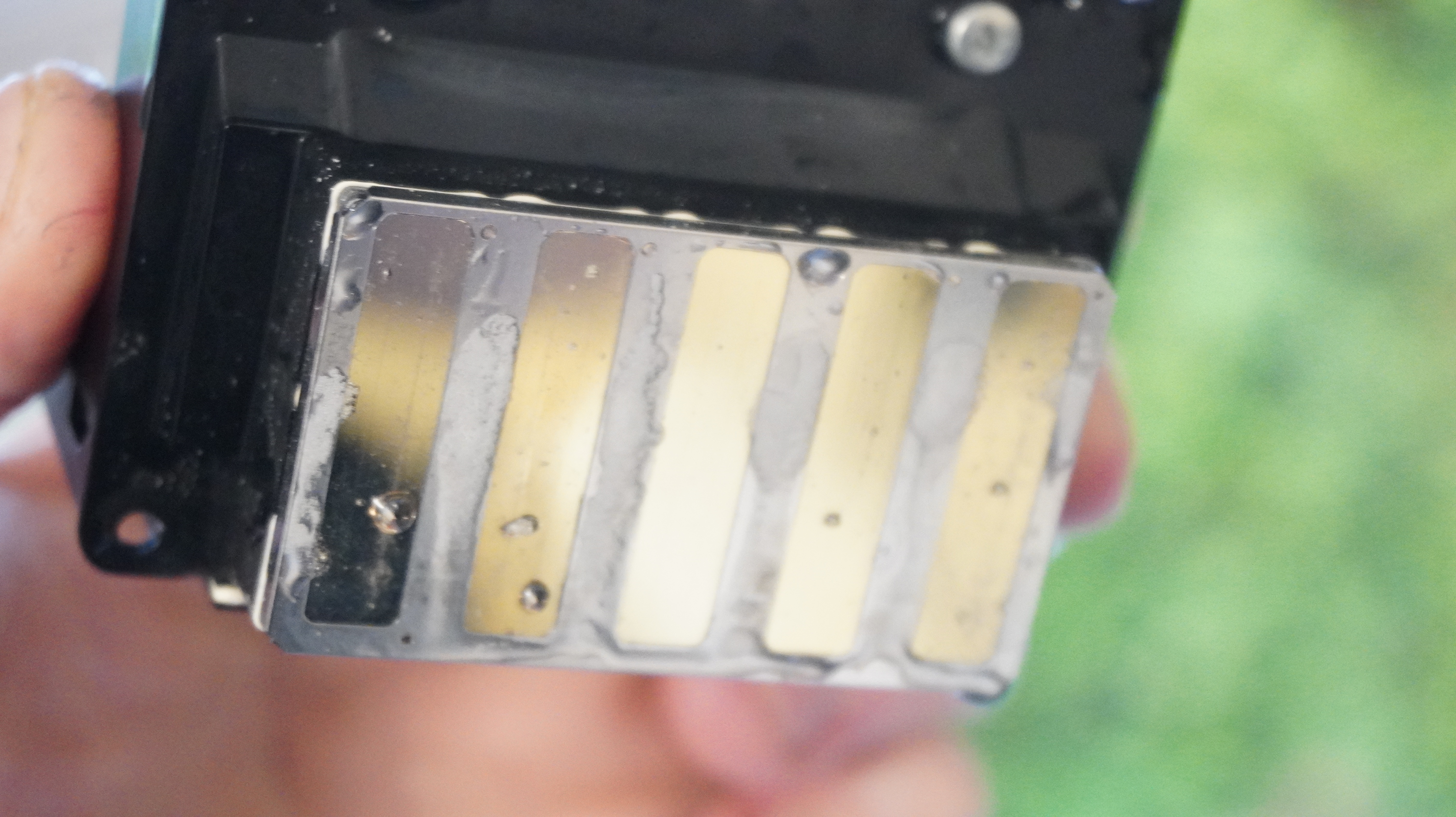

There is 5 x channels and the Middle two are totally blocked and the other 8 x nozzles all get liquid water through them
Does anyone know how the middle 2 x could have got that blocked? And the other 8 x are okay??

Im assuming the middle two are supposed to get ink through them?
Already left seeped in solution etc overnight
But the middle two appear totally blocked

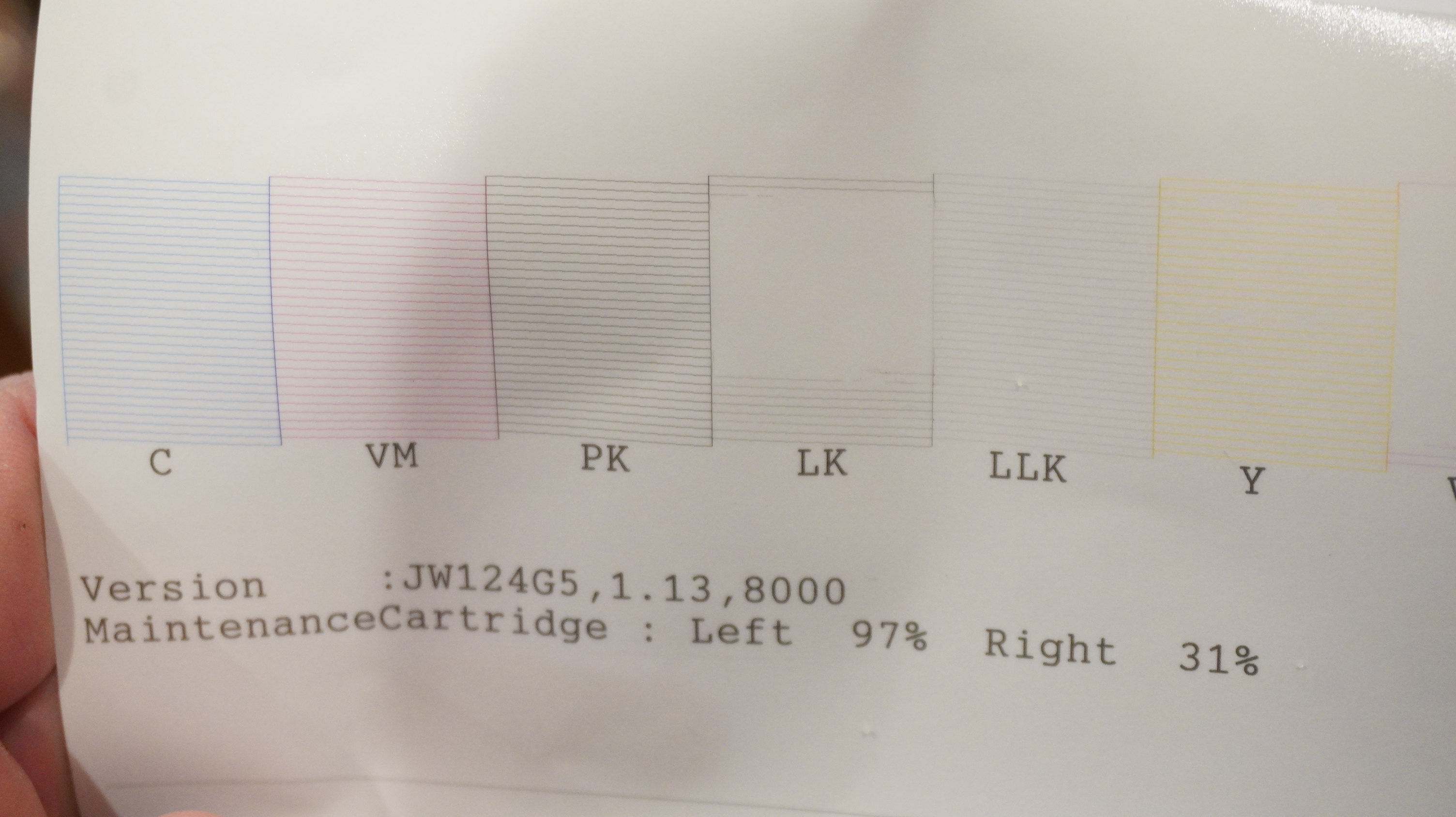

You can see the image nozzle check only the top and bottom of the VLM And LK Have a few lines

Ah okay so this head print attached above, you think that i will have to get a new head? i.e. its goosed?
i was wondering how it works as there is
10 x nozzles
9 x Inks installed
8 x Nozzle checks on printouts
Thats odd? as 2 x dont work the ones in the middle!

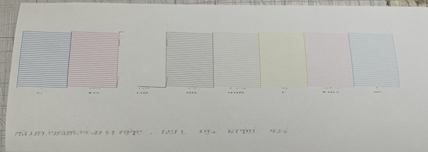

I will be back in a few days time with an update, I did plan on doing a print like this attached i found on the internet that just prints the colours i need to work on
Many thanks for the reply just what i wanted to know
