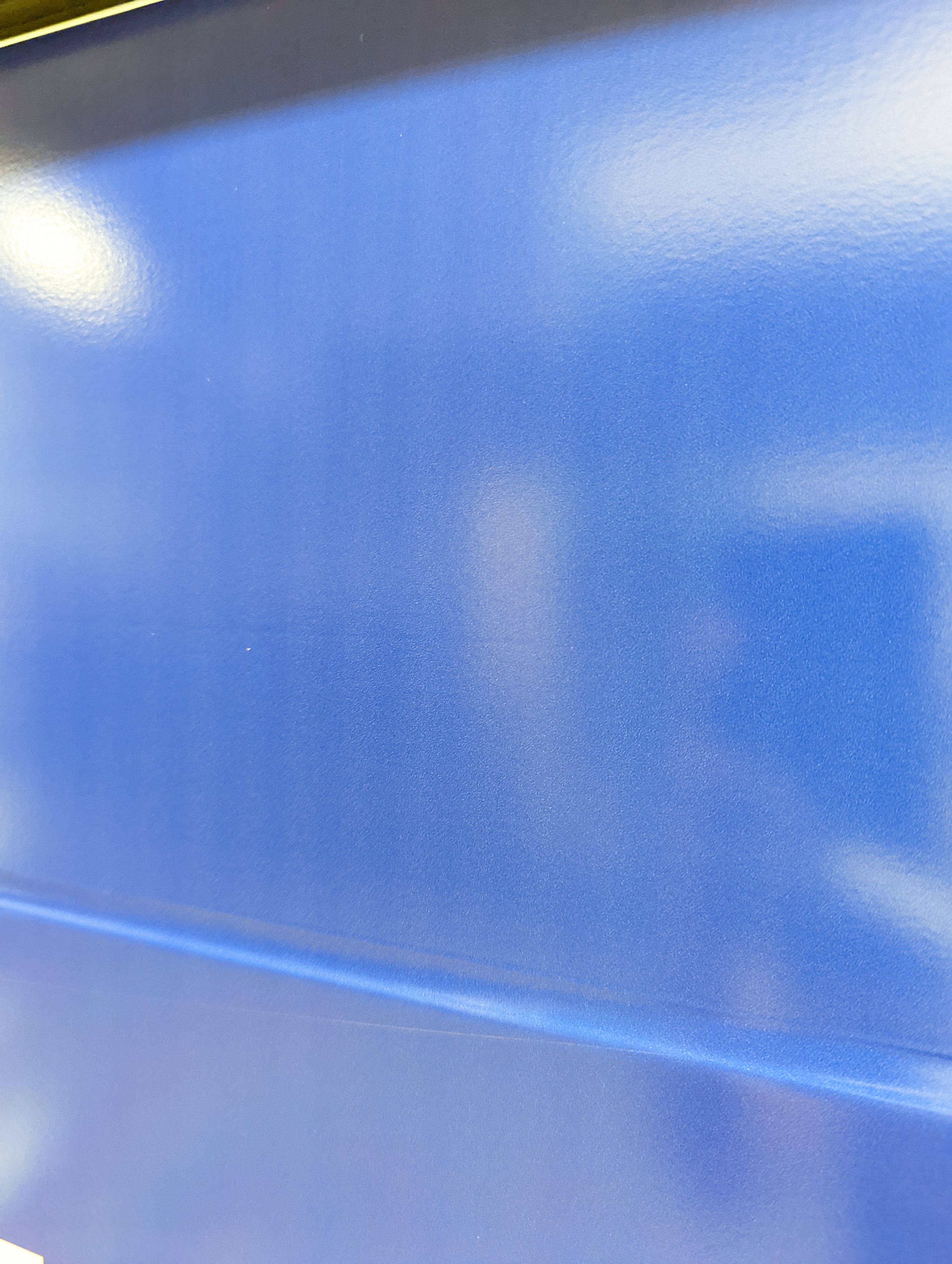

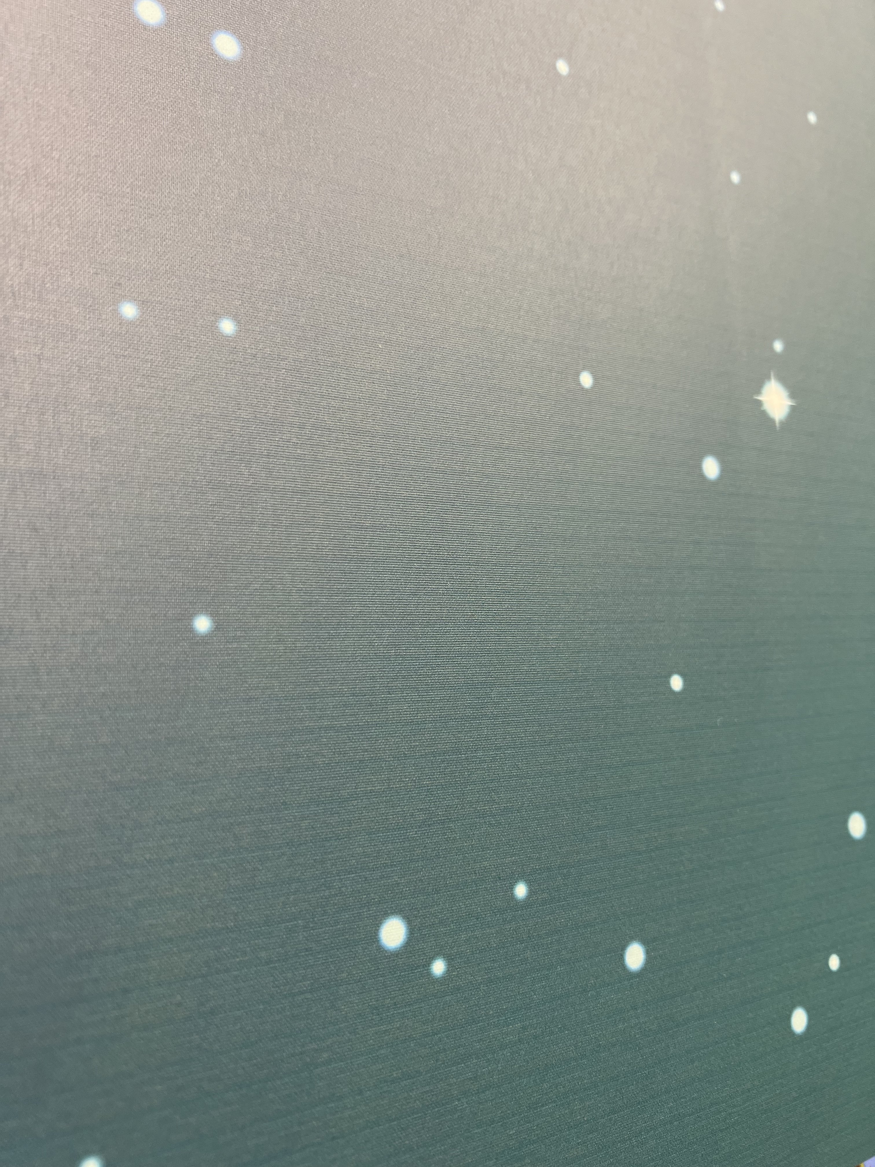

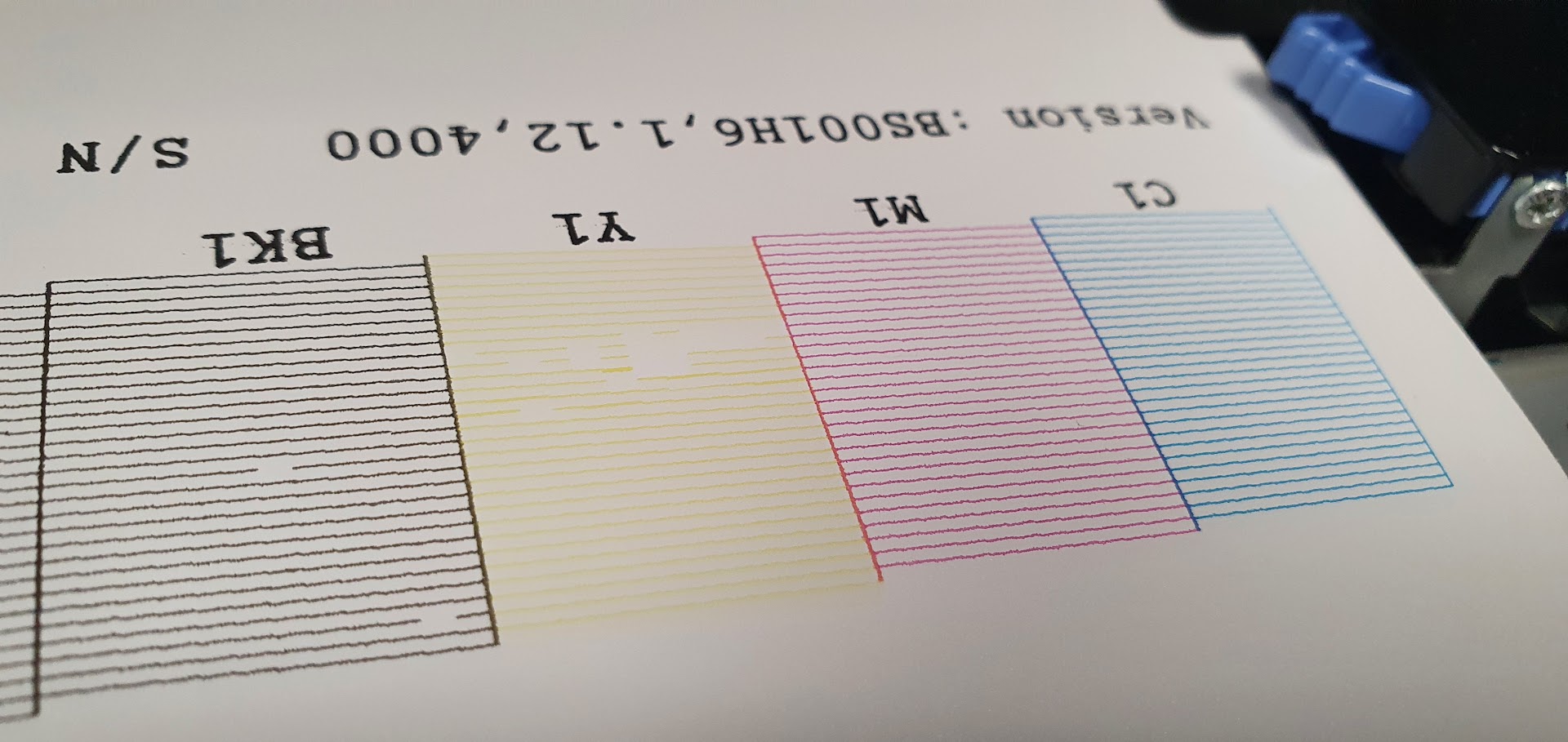

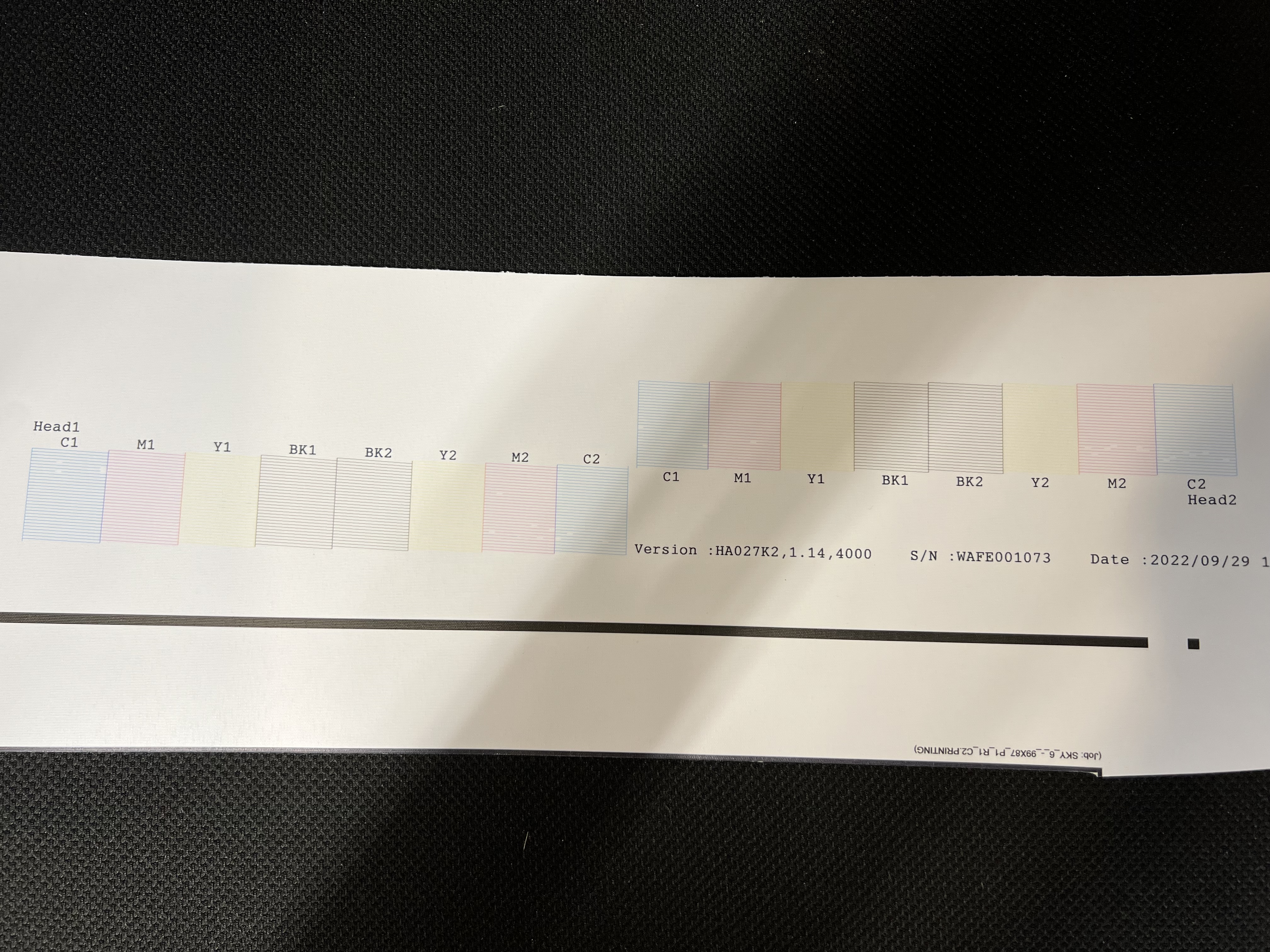

Tech came back today and swapped out the ducts. printer is now functioning how it should. this time he actually stayed and waited for me to do a couple of prints before he left so far its been working good.
here is the banding lines i was getting and nozzle check . that would go away after a (light) cleaning mode but then comes back after printing 10-15 ft.
UPDATE: ok so was able to print about 40-50 ft of material seems then started to see some band lines again then did a nozzle check and missing black nozzles now. did a clean and its back.
