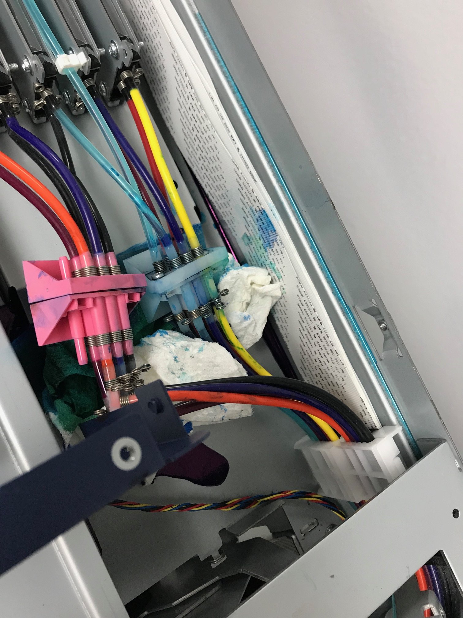

this is what is leaking - looks to be a simple part replacement. I will see if Epson will sell the part to me

They won't sell you the part. They won't sell anybody the part. Is this machine under warranty? If so, then there's no reason not to have them come. Even if not, having them out to fix it is not the end of the world, and it will be done by Monday if you call them now.

Its not horror stories...Canuck is correct, Epson HQ fields the call...they are great with application, rip, media, environmental and diagnosing issues...D1 is just the "tool" that comes onsite to repair what they find is damaged. Yes they will bring additional parts. Yes they replace and follow the issue to its source. Yes this is time materials and money....Are you sure you cannot contact the reseller that sold you your latest S80 to see if they can sell you a warranty for your original unit? It may be worth a call because of the swap you experienced...someone should have offered you an extended warranty.
There are 2 epson authorized repair dealers on the east coast...BenSak and Diversified Display...maybe they ca get you parts...

You would need to find a third party parts supplier like digi-print who has a terrible rep in the community. No reseller unless service authorized can access epson parts to even sell to you. Typically they won't because they obviously want to perform the service...its how they earn a living these days. Did you call the two east coast companies like I suggested? That may be your only option.
