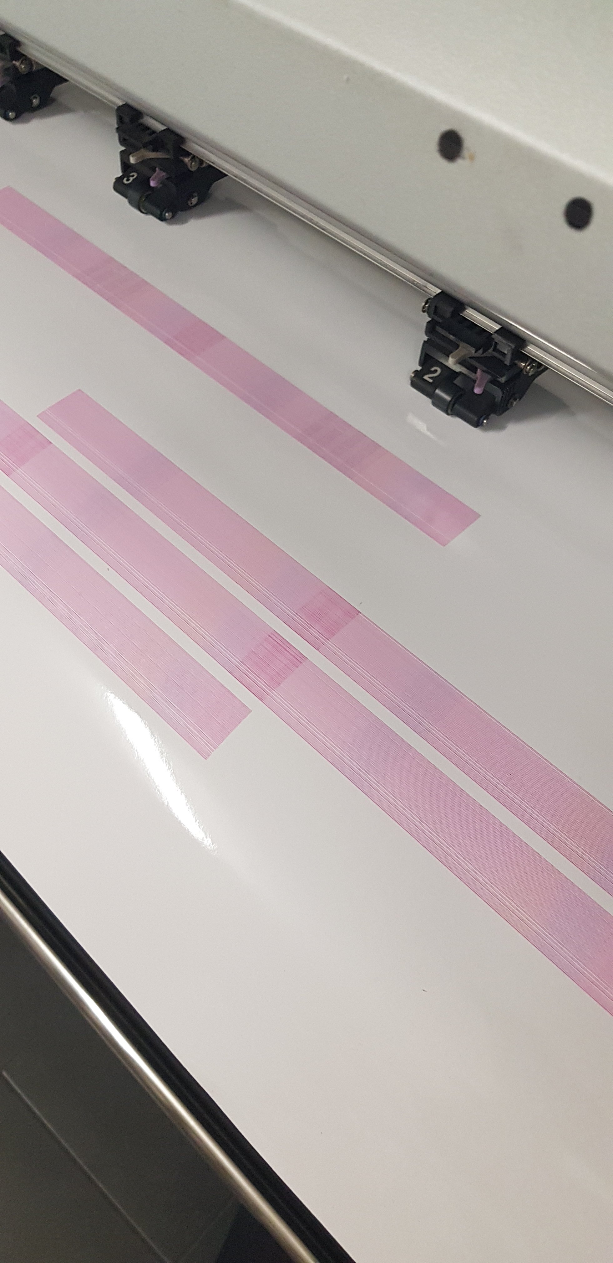

Hi, after changing the fuse I have another problem. The left magenta keeps on firing all the time during test print!
