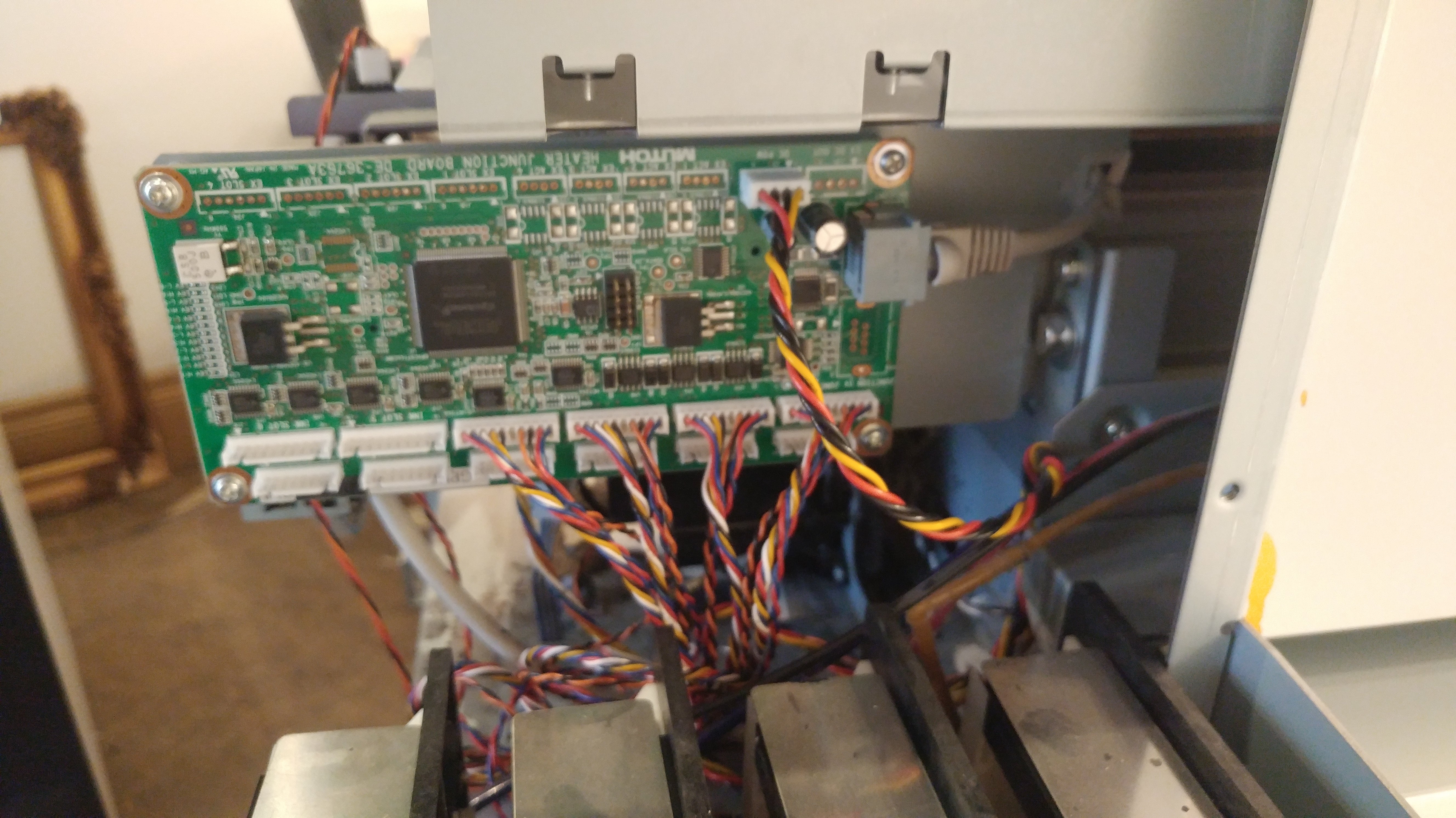

You are going to have to take the top right cover off, when looking at the printer from the front, and you should be able to see the board from there. It'a about 4" x 8" and will have an Ethernet cable plugged into it. That's the cable you need to take out and clean the terminal and then plug it back in. The other end of that cable is on the main board. There is a box hooked up to the bottom of the printer that has hinges on it. Take out the screws holding it up and you will be able to swing it open on the hinges. The main board is in there and is the biggest board towards the right, from the back of the machine.

Thank you. The cover has been off for years. Iv pulled out and cleaned the ethernet cable as suggested.

I'm not sure what model that machine is compared to for the Mutohs so it may be more like the 1304 and 1204 where the main board is underneath the back platen. That long metal piece that runs along the back of the machine where the media normally runs through. If there is no box, then that is where the main board should be.

OK got that off .. extremely dusty and dirty, cleaned it up ... fingers crossed.
