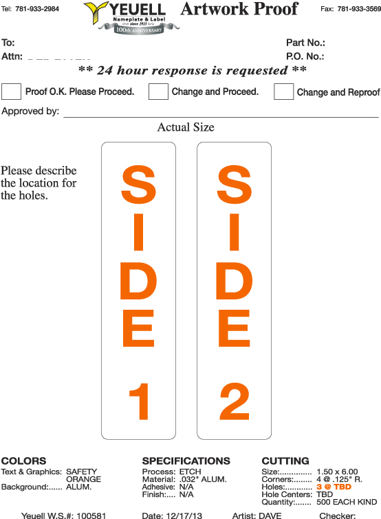

I have a customer asking me to quote aluminum plates like the attached proof. The proof states that these are etched and safety orange. Any idea how that would be done? I'm thinking they are really screenprinting these but maybe there is a process I'm not aware of.

Find your local industrial laser shop. Maybe they can etch then cut out the pieces? Then you could color fill with automotive urethane.
Another option may be sandblasting then color filling.

Best quality: fill with paint after etching. Milling is too expensive for the quantity.
Best price: screenprinting
axis
Job it out. This requires a combination of screen printing, acid (or alkaline) etching, and painting. It doesn't sound like you have any experience with (or equipment for) these processes, which will guarantee that you'll lose your shirt trying to produce them.
So quote them on the marked-up, jobbed out etch/fill panels and an alternate version, produced in-house, that you think would meet their needs.

One note, the material thickness is specified as .032" aluminum. That's quite thin. Chemical etching deep enough to get the fill is going to take a little depth. Since that sign is double sided, I'm not sure it would be possible to get very deep with it being double sided. Just something to pay attention to when quoting it.
Moze
Precision Sign Services
I would sub it out to Steel Art. Their "etch and fill" is actually blasted. It gives the same result. "Etch and fill" is an old term that is often used out of default. As long as the finished product is what they want, you should be fine. Blasting has replaced etching in many instances.

Sent them an email, thanks.
