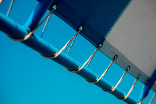

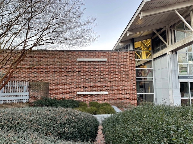

May I ask for opinions on how best to tackle this 10'x10' banner? I have a 54" printer, so it would have to be in 3 pieces (2 vertical seams). Would hem tape be suitable here since its against the building? Or the HH66 vinyl cement? I'm also a little confused about the installation method - what's up with the ball bungees? Previous sign person being lazy? One of these rails has a fiberglass rod through the eyelets, which leads me to think that this banner is meant to be installed with rope woven through the grommets. I'd like to do this in-house since we're a non-profit, but I also want to do it correctly, so I'm open to outsourcing. Thanks for your thoughts!
