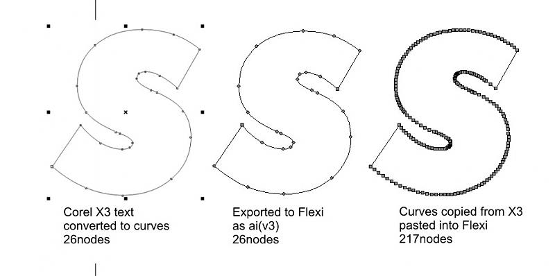

    I think it depends on what you are cutting and pasting.
    If you are moving text layouts and don't convert the text, it works pretty well.
    If you are moving complex paths or text that has been converted to paths cut and paste converts the smooth curves into tiny line segments. This may or may not be a problem again depending on what you end up doing with the file in Flexi.
    For cut files exporting out as a simple ai(version 3) has been bullet proof for me.
    wayne k
    guam usa

    copy and paste definitely gives you more nodes. but for quick graphics its ok. its hardly noticeable. and as far as designing in corel and not in flexi - my biggest beef is the graphics quality in flexi. nothing looks like what its supposed to.....thats why i also stick to the design in corel and export as eps and open in flexi.
