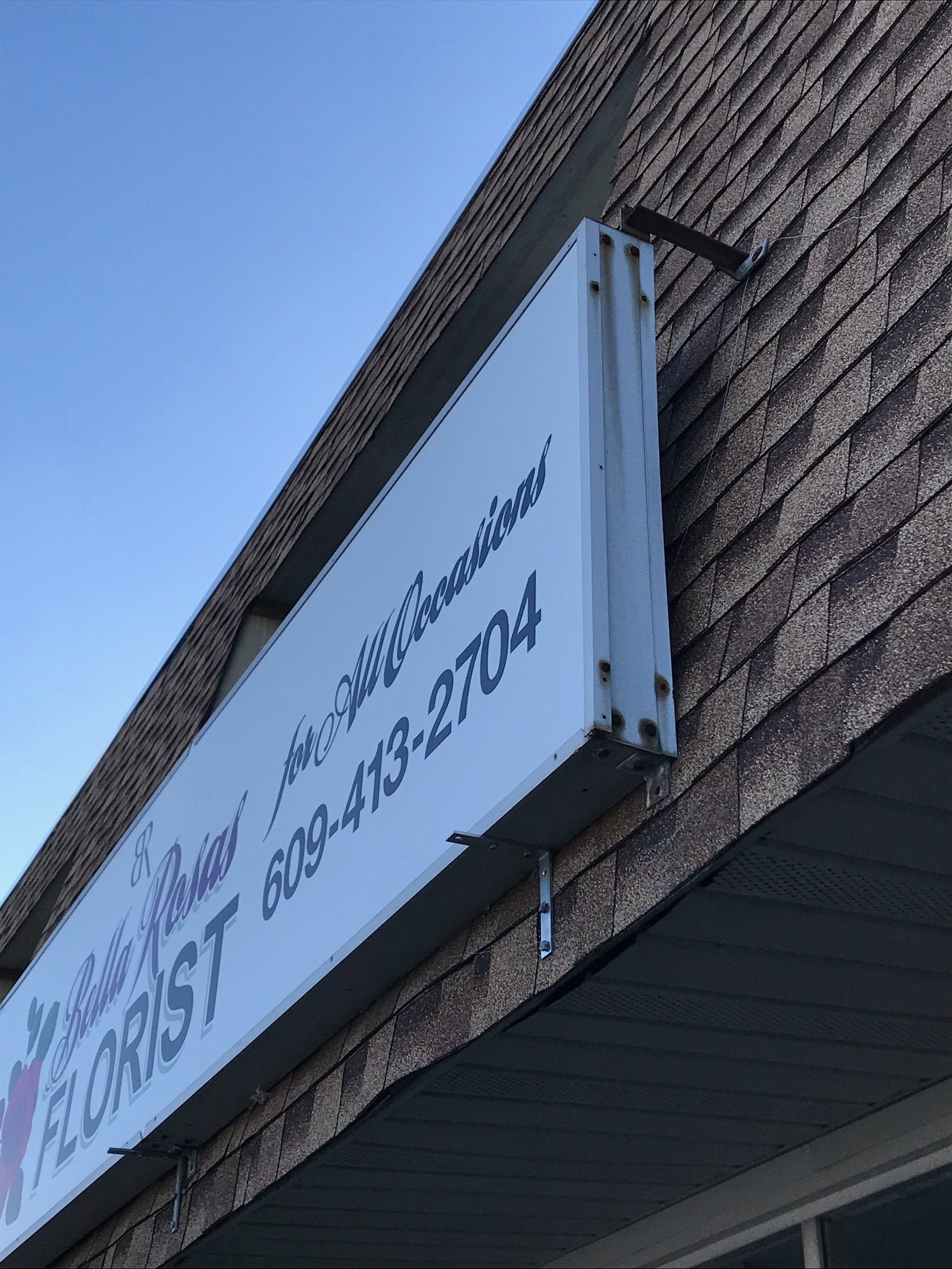

My fault for resurrecting this old thread. I have a new client asking to replace his sign because of hot spots. I'm going to work on getting the info and photos before I reach out for help. What I do know is that the box is decades old with a flat sign face, not pan face. Waiting for him to report what bulbs are inside before I head over to inspect.

So I asked the guy to send a photo of his light box, (attached). He's asking if there is any way to fix the hot spots. Says at night, all you see is the three light bulbs. Box looks like it's only 3-4" deep. Do you think a pan face would fix it? If not, I'm going to recommend LEDs or a new light box. Thanks.

Overall that box is a joke, no offense. It looks like it was made from two smaller signs, used uncoated fasteners, the brackets across the bottom were too long and never trimmed, plenty of other stuff.
I'd argue the opposite, this can looks fairly shallow, and to get it lit uniformly would probably be way too many modules for the customers taste, especially considering the appearance of the cabinet in the first place. I'd jump on a pan initially, then come back with a different cabinet built 10" or more deep.
I should have elaborated, investing into a new Pan Face for that sign would be like putting lipstick on a pig & as sure as s**t, once you replace the face something would go wrong with the electrical and you would be blamed.
LED would still hot spot some but would be much more spread out , making the sign more readable than how it is now & would be a cheaper and quicker band-aid. You can also use the LED lights and transformer once they're ready to pony up for a decent cabinet, as JBurton said.
