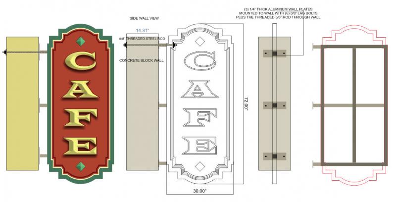

What best suits the job. I use a fair amount of 1/2" and 3/4" for backgrounds. I often use multiple layers as most of my work is dimensional. I get really creative coming up with solutions when I fabricate my stuff. You also have to be mindful when working with these materials of expansion and contraction issues. I sometimes use a 1" or 1-1/2" square tube frame work and attach faces to both sides. On the ends or tops that might have a profile, I'll sandwich inside a filler of PVC or HDU to finish up the edges.
Here's an example of a sign I did a few months ago built the way I just described. The center framing was 1-1/2" square aluminum tubing. The top and bottom was HDU. The faces were ACM. But the sign was built like a tank and will last for many years.

That is a sweet looking sign-Signmaniac! And for jobs like like I like the fabrication techinque. My question is more about basic sign jobs, you know, a 4'x6' double face sign between two posts, colonila shape, basic office sign, when $100 does make a difference in the sale/profit.
