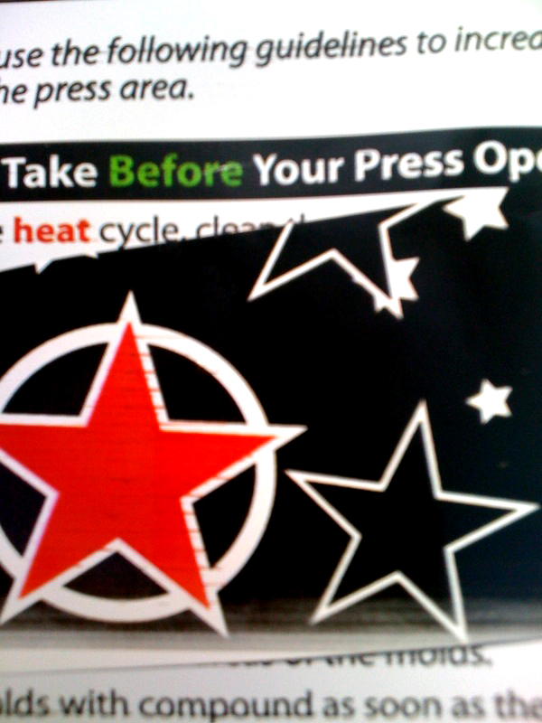

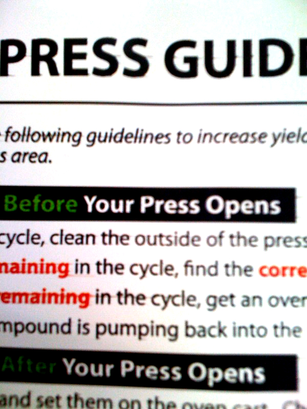

Here is the problem I'm having. The black and Magenta are streaking. This was printed on the low head height and I also tried it on the Middle head height with the same result. All heads are lint free. The streaking doesn't happen during a nozzle check. Pictures are blurry because of my cell phone camera.

you have lint or something on your heads. use a cleaning swab and some denatured alcohol and clean it off, do a head cleaning and then try it again.
Graphics2u
Check the entire underside of the printhead carriage and make sure it's clean. Is your material buckling due to too much heat?
Hummer69
Thanks for the help. Outer part of the carriage had some fuzz on it causing the streaking. I was too focused on keeping the print heads clean and missed it.
