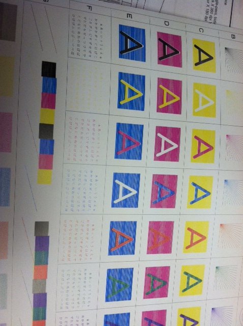

We just put in a new head board and got it to finally print colors. Now our problem is getting it to print correctly. Here is a picture of the test print we did. Would anyone know what all to do in order to get it printing correctly?

this has nothing to do wit a reset, head alignment is what you should perform. look in the service manual.Paco

Yes, I do know that. I was asking about the reset before we got it to print color. Now that we got it to print we need to get everything printing correctly. Weve looked in the manual but the way its worded you cant understand half of it. We think we need to try and get the head tilt?
SlightlyChilled
Make sure the heads are sitting all the way down in the groves. The little leavers have never really did much for me I would just set them in the middle. I have the screw with the brass washer lose and pust the head to the back then lock down. Do the same with the other. Run a test print you might need to move them to the front a hair but with them in the back of the holder you konw what way to move it... Take your time you are over thinking it.
CRD
Head aligment is like SC said try and error. As long as you know what you do you will get there in the end with a working machine. Paco
