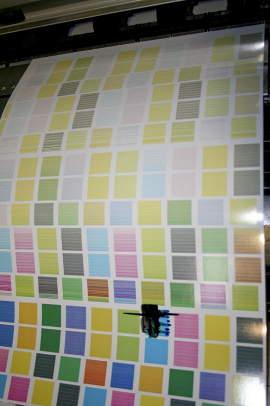

Test squares are printing pretty light, then go down to almost nothing.
Looking for possible causes, fixes, workarounds.
Printer has brand new print head. Printed on it for about 20 - 25 days after installed. Then a project that wasn't printer related kept us occupied for a little less than a week. (Maybe 4 days) Went back to printing, and we basically got nothing.
Cleanings and power flushes only get us to about 65% solid coverage with banding still. Then they eventually go back to fading out.
What am I over looking? The dampers are a year old, but aren't leaking. I've got some new ones on the way. Would they actually be the cause of the lack of flow?
(The blob in the picture is from me massaging the dampers)

Practically non-existent at this point.
However, if I do a vacuum draw directly off the head, I can get a pretty decent nozzle check. But then it goes back to printing lighter and lighter.

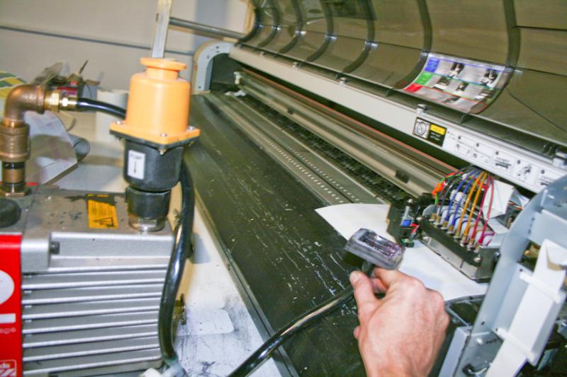

Here's my set-up I came up with for unclogging the print head. This doesn't put extra strain on the printer's pump, as well as reducing ink amounts on the chips. Every time you run a cleaning cycle, it ticks off "X" Amount of ml's of ink that should have passed during cleaning cycle... even if the actual ink amount is less than that because of a clog.
Plus, the peristatic pump can't draw as nearly as hard as my 2 stage. I created the little capping station on the CNC Router, and then with the print head off, I cast a mold and poured silicone around the head to create a perfect fit and tight seal everytime. And it's real silicone, not kitchen and bath stuff. You have to mix it from 2 parts, and it's a platinum cure so it's solvent resistant.
