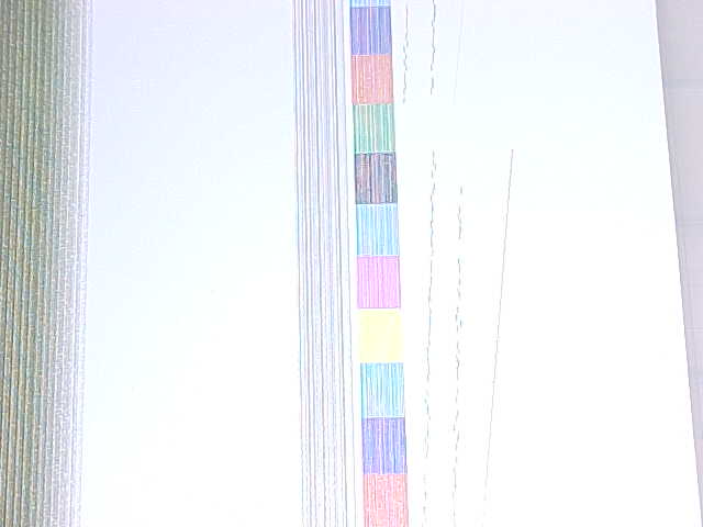

I'm having a problem with my mutoh jr. 38. I can't seem to get it to print without having lines in the prints. I have taken a picture of the nozzle check. I was hoping for some ideas to solve this problem.

no really, do a few powercleans and start there. nozzles are clogged.

If you have the maintance manul go to page 142. you will need to set the trandsport distance parameter.
QCman
You test print and add or subtrack the reading. and retest. you will get dowm to adjusting 1 mil at a time.

have you cleaned with cleaning cartridges yet? When mine acts up i slap it around, yell at it a lil then put the cleaning cart's in and run a cycle, and its usually fine...
