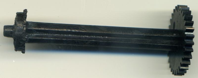

Anyone have any idea where to find this part for a Falcon Outdoor Jr 38.
It connects the pump to the pump motor. You'll notice on the left side of the pic that the gear teeth are shredded. The pump itself works fine.

That gear is not replaceable. You will need to replace the maintenance station. Last one I bought was from Mutoh through Gregory was $350.00
Jackpine is right, the only way to get it is to buy a maintenance station. The cheapest I have found them is CMYKparts.com but I have not checked with Gregory. Let us know what you find out.

The problem with that gear is it costs 11.00 for the gear and 15.00 to ship it. Either CMYKparts or inkjetsupplies carrys it. I can't remeber which one. Mine broke earlier this year and I replaced just the gear.

Hard to believe that a 3" long piece of plastic would require replacing the whole station. I just might be forced to go into "Engineering Mode" and machine one, or retrofit one myself....

Gear teeth are not shredded. They melted from the solvent in the ink. Try CMYK, I bought my maintenance station from Gregory and it was shipped from Mutoh.
