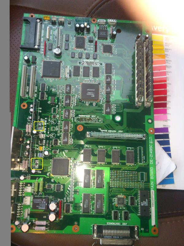

Umca
First of all you have to check fuses on mainboard if printhead not firing.
Places of two fuses you can find on picture (in yellow squares)
