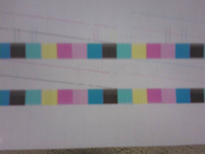

I have been having some issues with the head seeming to fire and cause print marks all over the print ( no matter what media ) Have cleaned it several times, cleaned the encoder strip with no fix. The carriage seems to bind a little as it moves both directions and makes alot of noise. I loosened the band and checked the wheels on both sides. The wheel on the y motor spins freely from the shaft ( is this normal ) also I noticed if it is supposed to spin freely, that the wheel seems to wobble alot. IS this a simple replace the wheel or will I need the whole motor, Or is there something else that could be causing these lines. The carriage seemed to move fine when I moved it back and forth with the y motor out. Any suggestions

pic of print
here is a pic ( not the greatest )

It does wobble a little, however not sure if this wobbling is causing the head to fire. I may try the loctite and see what happens before I order a new motor

You definately need to get the pulley glued back on tho the shaft. Then see if you still have the other problem.
