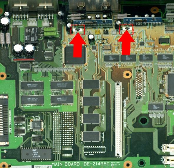

Yes, the fuses are here...
toodark
Cool, I will test them 2morrow. Which is for head 2? Does it say by the fuses whic fuse is for which head?
toodark
No contuinity through fuse. :frustrated:What is the best place to take the board and have the fuse replaced? I can not find anyone local to work on printer. Maybe a computer repair shop?

Found a computer repir shop that is going to solder it for me. I figured I would mess something else up

Do you know of a aftermarket part number that would work. The local electronics store was not able to cross reference that.

BobbyFosson
Get the $8 fuses... cheaper to pay that and get it running rather than postponing production a few days to save a few bucks.
Stealth Ryder
Dont waste your money! I REPEAT... Dont waste your money!
You can do this yourself, I did it! Read this thread completely and you will learn how to replace the fuses with Radio Shack parts and a soldering iron.
http://signs101.com/forums/showthread.php?t=45626&highlight=Mutoh+Fuse
Wasn't exactly that suggested above and the guy said Radio Shack don't have the fuses... I find that hard to believe since I buy them at a Radio Shack all the time but who am I to argue with him...
